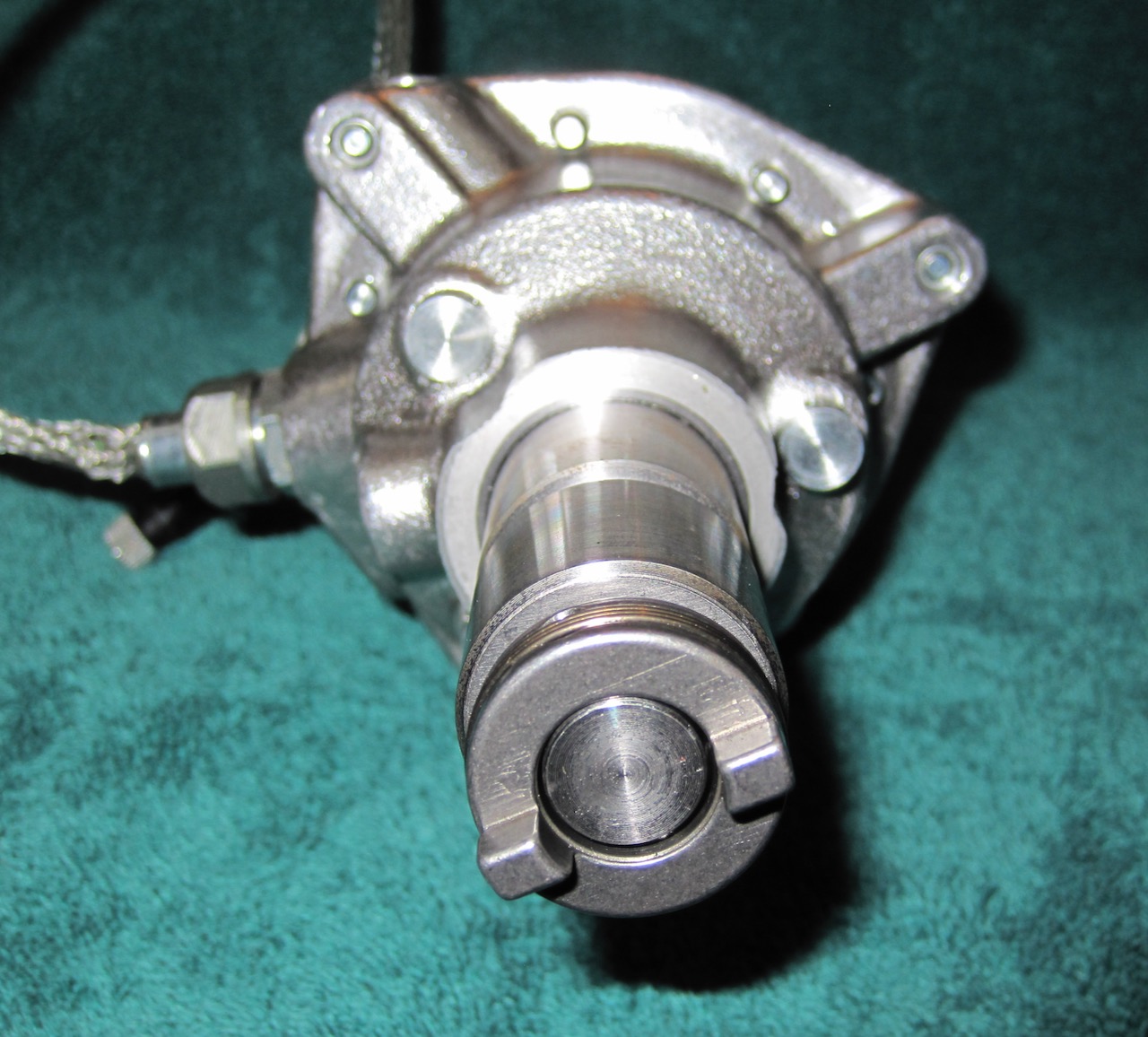

Going on the assumption it ran well before, then I suspect the slotted shaft
of the distributor is clocked 180 degrees out of place. Rotate the slot position
then you may be able to rotate the body of the distributor in the opposite
direction away from the cooling shroud. Just think'n ://

The cogs (teeth) on the bottom of the shaft are not 180 deg opposed through their centers, so it's unlikely that the distributor could be removed and rotated. It's possible that the internal plate, weights and springs have become corroded over time and now need a good cleaning and lubricating.

im reffering to the distributor driveshaft its inside the engine and accesable through the same hole the distributor goes in look at the manual page 36, Fig. 79, section A its possible to move it over a tooth and that was my problem.

I didn't realize that you could remove and adjust that internal shaft that drives the distributor. I learned something new.
