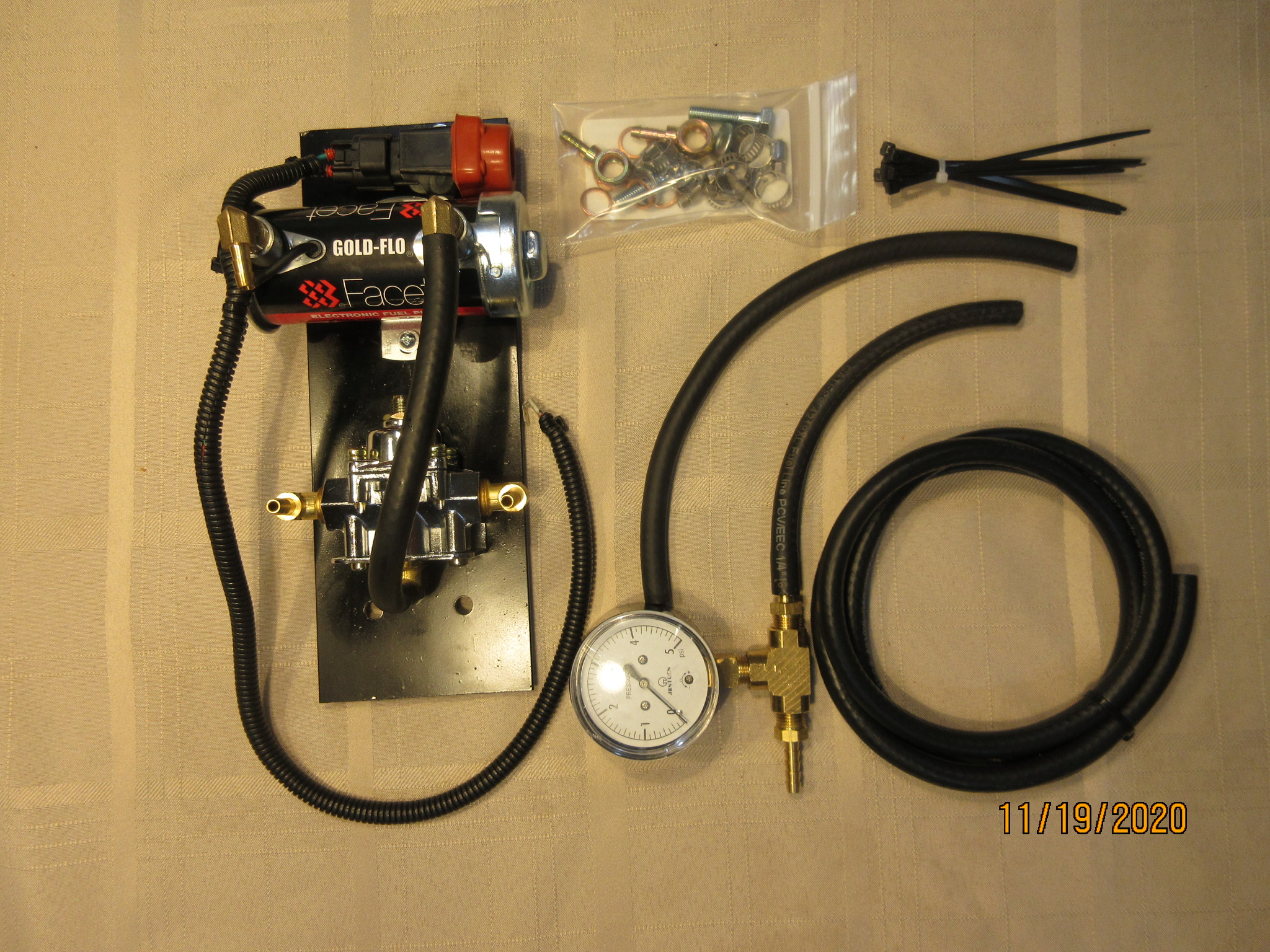

- Posts: 940
- Location: Indio, California
Re: fuel pump issue
I mounted the PinzFDS right on top of the engine. I have had this for 7 years without any temperature related problems. The pressure is set at 3.25 PSI.
