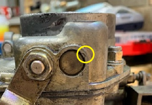

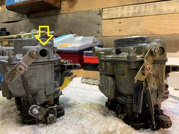

Well, now I have a new twist for you. My announcement was shortly after a test run with the intake manifold and air cleaner off. When I put the truck completely back together she fell on her face as soon as you pushed the accelerator with any real authority. So, I decided to start form zero with a recheck of the the ignition, valves and carburetors.
While in the process of reassembling number 1 carb I found a part missing. See the pic below. Carb 1 on the left. Carb 2 on the right.
That's a 10mm hole in the side near the accelerator pump! That side is away from you when you are fiddling with the mixture screws and the idle. I do not know when or how this plug came out. I have to assume this is my main culprit in the trouble I have been having. I will not know or say more until I have the hole plugged and truck up for testing tomorrow or the next day.
Have any of you seen this issue before? - Buzz
Re: Number 1 Carb issue.
Posted: Mon Feb 08, 2021 2:23 pm
by heinz
Hi Buzz!
I think that this may be the hole you are talking about. This is the air hole for the starting device. I practically don´t know if it´s affecting the function of the carb, but it definitely shold be closed to the outside.

Posted: Tue Feb 09, 2021 12:00 am
by Buzz
Got your pictures as PDFs and was able to open them by downloading and opening with Adobe. And yes, you are correct, that is the opening and I think it where the super rich condition was coming from. I think the vacuum was acting with the hole and was pulling fuel up to flood everything. All was well at idle and low revs. Then when I stepped on the gas the fuel was pulled through without any regulation by the jets. I have replaced the plug and will post pictures of the repair tomorrow. I am up past my bedtime; but, optimistic about a resolution.

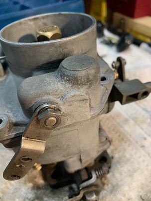

Ok, I replaced the plug on carb 1 the other night and am happy to report that the truck is running like a champ. Maybe, better than ever. I think that plug had been leaking a long time and it may be something others may want to check on their own trucks.
As posted earlier here is what I found as I cleaning the carbs in pursuit of the gremlins that had been eluding me for weeks. The hole where the plug fell out is marked with the yellow arrow.

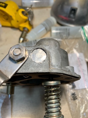

This plug is not shown as a "part" in any Zenith parts manual I have been able to find. Looking closely you will see the plug was made slightly concave and then "dimpled" with punch or press to expand the plug in the hole. Then it was staked to further prevent the plug coming loose. I have marked one of the impressions meant to retain the plug.
So, to make my own plug, I used some thin aluminum scrap I had on hand to cut out a square blank. The hole itself is stepped with small ledge running around the circumference of the inner edge of the hole. The ledge is 1 mm deep and 1 mm wide. I found that a 7 mm socket fit in the hole and against the step very well. So I used the socket to make a pattern.
I then used some heavy scissors and files to progressively fit the blank until it was about 2 mm too large.
Then placed the blank over a hole in my vice to put a dimple into it with a punch. If were doing it over again I would probably just use washer as the support to punch the dimple.
Next, I took the dimpled blank (plug) and placed in the hole convex side up and seated it in place with first the 7 mm socket as a punch and then gentle tap with a flat faced punch to expand the plug in the hole.
Last step, as insurance, I covered the plug with JB Weld TankWeld
I will probably go ahead and put JB Weld on the second carb also. The elimination of the leak gives a startling improvement in performance and I sure do not want a second plug to fall out. Especially, if I were off road somewhere.
