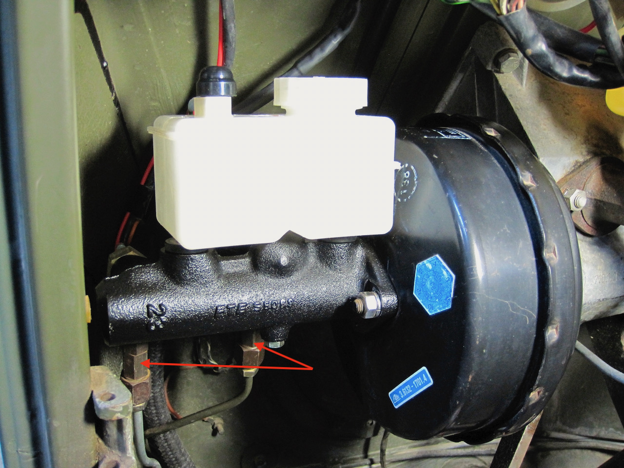

On one of the 710M's I bought years back, I had a similar problem with lack of braking in one circuit. It turned out that one of the Static Pressure Valves, part # 7103366220, had been installed backwards preventing the flow of brake fluid.
The attached photo has the 2 valves marked with arrows. Worth a look anyway.

I finally got around to getting a photo of my master to see what I have for valves that might be wrong. Any way to tell which way they are supposed to go? And should there be two stacked on each line. Assuming that is what those are in the photo I attached. [attachment=0]IMG_3559.JPG[/attachment]

I took a pic of mine
looks quite identical

I had a look at the Austrian drawing that Albert supplied but did not clearly see valves however group 07-05 shows item 35 that I do not know what its function is as I only have the illustration without the legend. Pcolette earlier mentioned static pressure valves part # 7103366220 that had been installed backwards and preventing the flow of brake fluid.
Albert can you clarify what this is and why are there two of them as shown in your and Jungle Fever’s photos?
