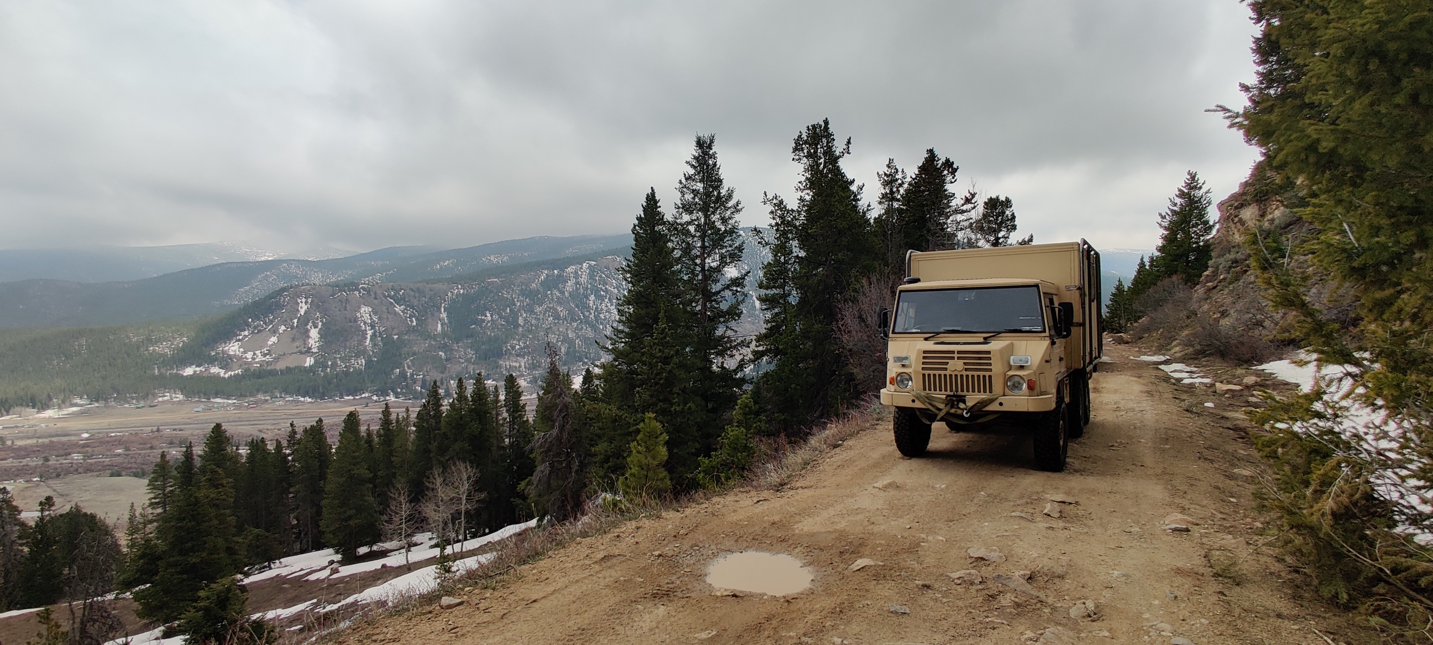

So finally getting to use my Pinz as it should be, getting it off road and camping in it. Just wondering if it's possible or advisable to put a wheel with a different offset on a 718.
I'd like something to give it a little wider stance for stability and looks. Nothing radical, but maybe 1.5-2 inches. I know I can get custom wheels made to order, and from what I can see, there's nothing to rub on. Please give me input. Also, if this works, I might have 7 factory wheels with brand new KM3s on them. :D
