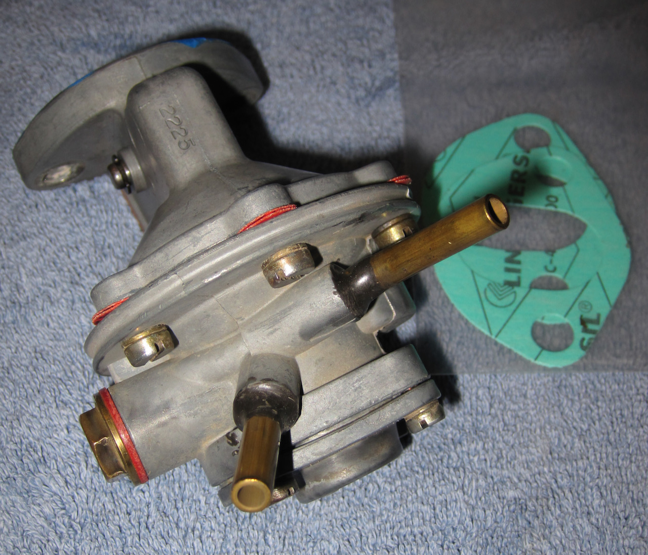

Thank you, I did just that and it became pretty clear that it was the brass outlet from the fuel pump. It wiggled in and out easily and when I turned over the engine it starting leaking from that connection immediately. I cleaned the brass fitting, sanded the exterior lightly, and used JB Weld to glue it back in place. We'll see if this does the trick. Worst case, I'll be replacing a fuel pump. Thanks again.

Hersir wrote: Sun Jun 06, 2021 12:45 pm Thank you, I did just that and it became pretty clear that it was the brass outlet from the fuel pump. It wiggled in and out easily and when I turned over the engine it starting leaking from that connection immediately. I cleaned the brass fitting, sanded the exterior lightly, and used JB Weld to glue it back in place. We'll see if this does the trick. Worst case, I'll be replacing a fuel pump. Thanks again.
if the epoxy repair doesn't work, then you can get just the top section of the fuel pump as a replacement part. As a bonus, that section includes the two flapper valves that get tired over time and cause a vehicle to be hard to start after sitting for a few weeks. Change that part and she'll start right up even after several weeks of sitting idle.
Others have reported the epoxy fix works pretty well, and yours is certainly not the first to develop a leak at that insert location.
