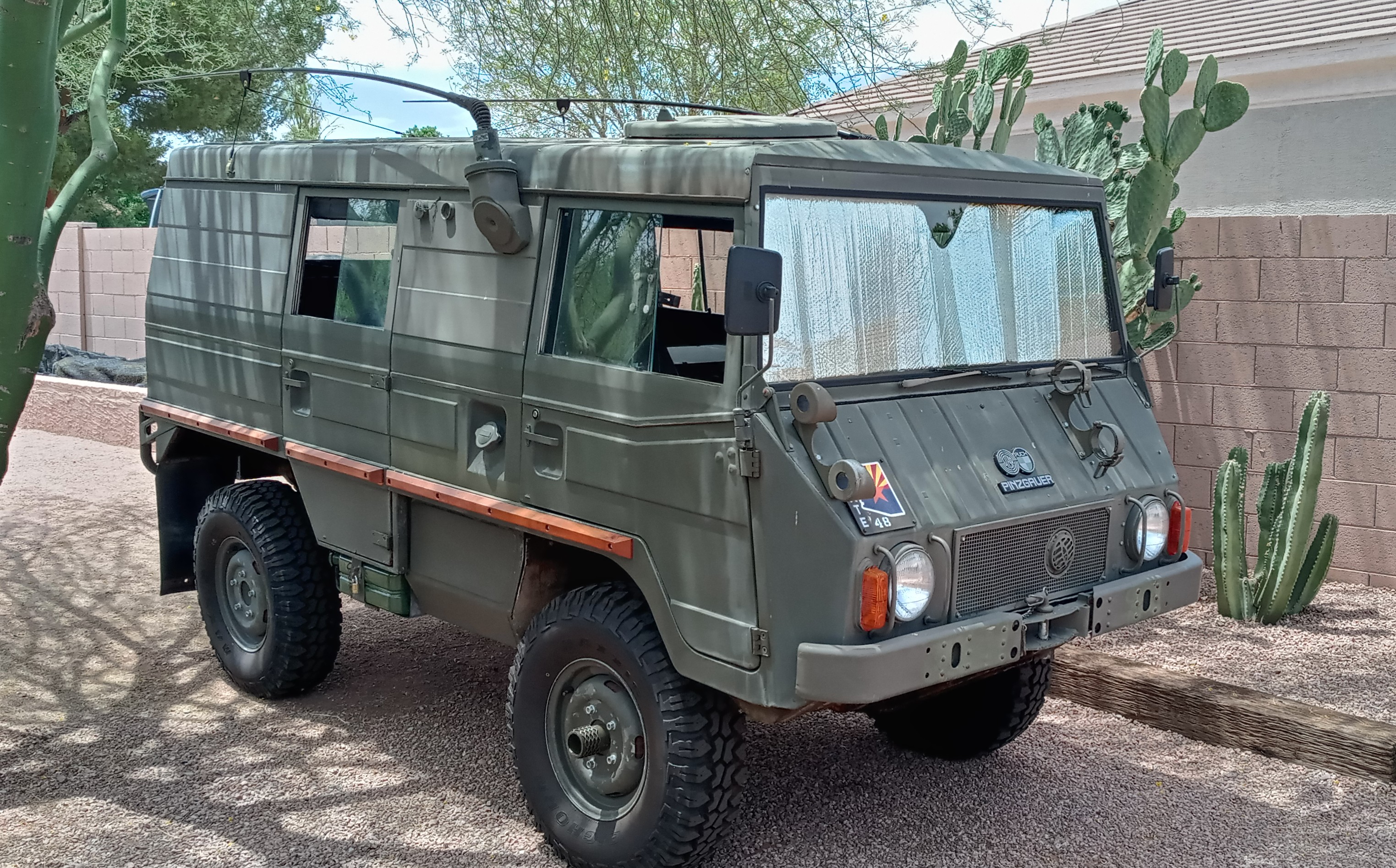

I actually joined a couple of months back, just getting a chance to introduce myself. I had been looking for a Pinz for a decent price for a while and last October I ran across one in Tucson (I'm in Gilbert AZ), so we went down and got it. Its a 710K. It hadn't run in several years - the owner said it ran great until he tried to convert it to civilian ignition and he never could get it to run after that and kind of lost interest. I found the pertronix unit to be mis-wired and he used too long of screws and buggered up the advance mechanism. Fixed all that - put stock points back in and it fired up and ran great - then left me on the side of the road when the pertronix coil failed (to be fair, I think the previous owner damaged it trying to get it to run). I put a Bosch blue coil in it and it runs great now. I changed all the fluids and filters, put new tires and batteries on, found some antennas and put them on and I replaced the rub strips with some mesquite I had. I've since put about 300 miles on it. I am going to have to deal with the red death soon - I lost power the other day going down the road and had to stop and blow out the fuel line to get home. I have been devouring the information on this site and it has helped me immensely.

Welcome and congratulations on a nice truck! Side rails look great!

Nice, which tires are those?

Thanks. I went with Maxiis Big Horns 255-85/16. I don't know how they compare to others, but they are wonderful compared to the stock Mayolas that were on it.

Congratulations!! Looks like a real nice K.

Since I'm starting my tire hunt, how do you like those "Maxiis MT-762 Big Horns 255-85/16"? Beating the Maloya bar isn't tough. Those do have a nice look.
What other tires were on your short-list?

I was considering the BFG MT's in the same size and the BFG MT's in 265/75-16 as that's what I have on my Xterra. I ended up going with the Maxiis because I liked the look and they were on sale at Simple Tire for a really good price.
