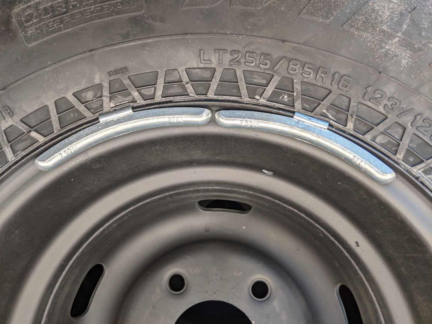

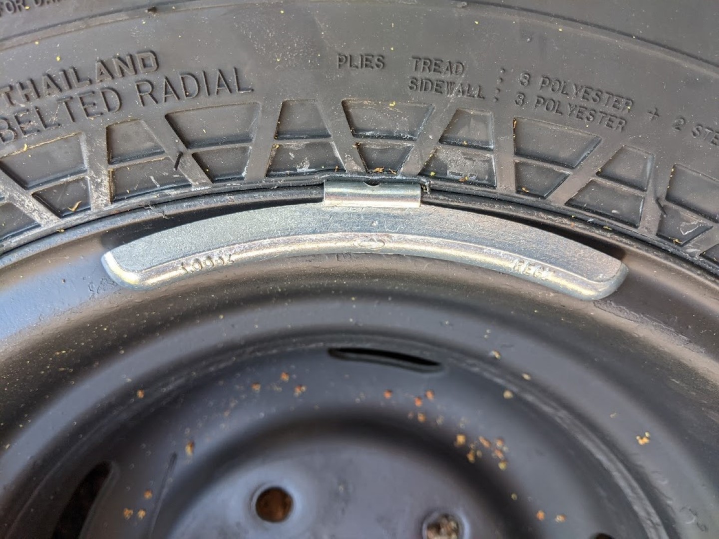

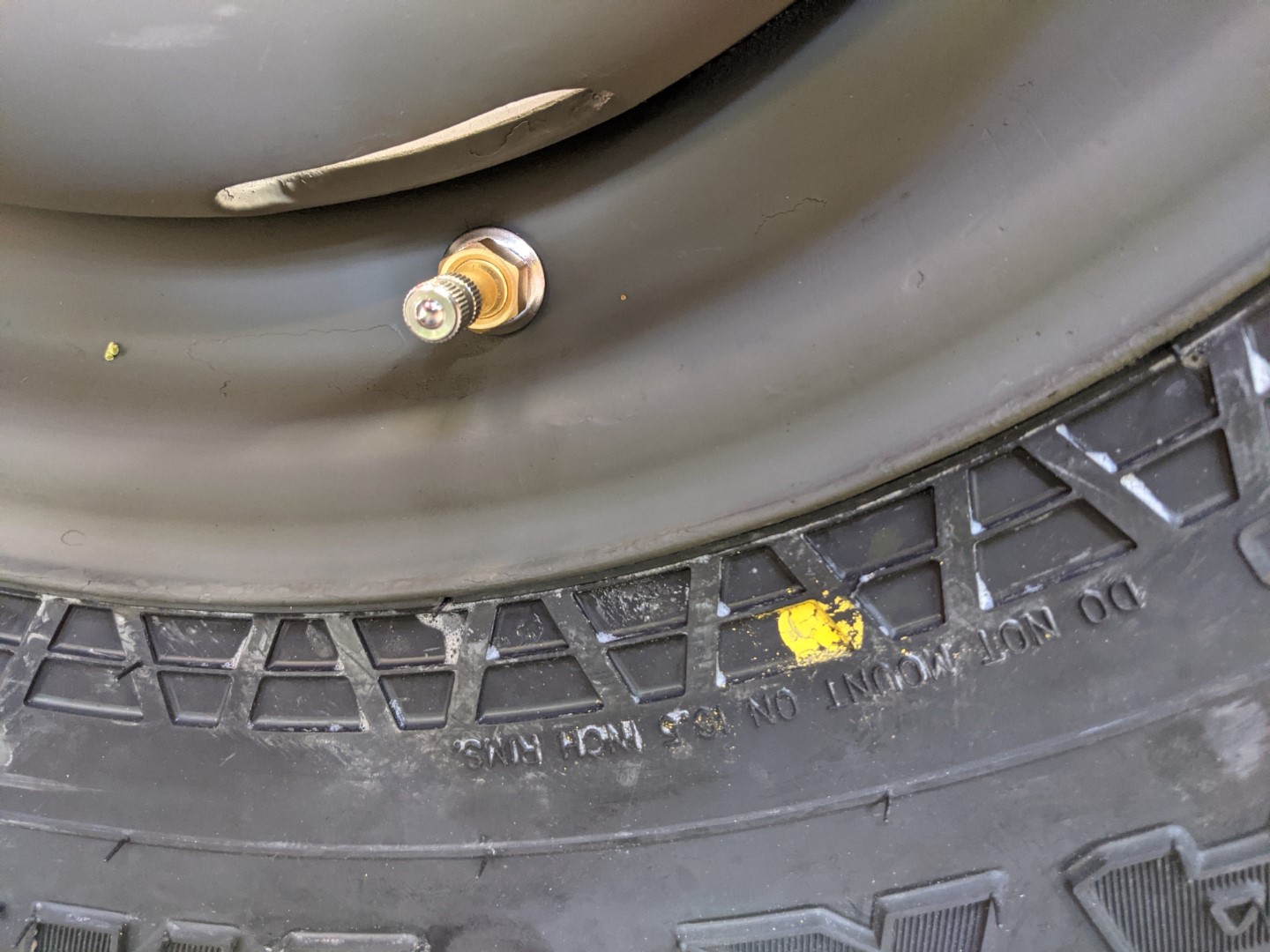

Just got my new LT255/85R16 Falken Wildpeak M/T tires mounted to factory wheels, but am nervous about the balancing as they all seem to have a lot (for what I'm used to) weight. On all five, the weights are at the same clocking as the valve stem, and are 1.75, 2.25, 2.75, 3.00, and 5.00oz. All tires were mounted with yellow paint spot clocked to the valve stem.
1) I suspect they ignored my request to balance lug-centric and balanced hole-centric.
Has hub-centric balancing worked out okay for others on the factory Pinz wheels?
2) Does this sound normal as typical weight for these kind of tires?
My other trucks (Toyotas) with bigger tires all have much less weight on them. (Bridgestone & Cooper A/T tires on steel and alloy factory wheels). These tires weigh in at 59lb, so 92lb per assembly. The "1% rule" for maximum weight would be 14.5oz, so from what I can read this amount of weight is "okay".
3) Those weights look like they're curved for 15in wheels, not 16in. Thoughts?
For those who don't know what the yellow spot is, it's the lightest point of the tire: https://www.yokohamatire.com/tires-101/ ... your-tires, so it makes sense that the weights would be added here.

Pretty much guaranteed they did not balance lug centric. That's a pretty
rare adapter and one no shop would have. So....I'd say good change you
are not balanced. You could...try to see if she holds well at HWY speed,
or remove the weights and get yourself a set of balancing beads. There are
beads small enough in diameter to pour down the stem.

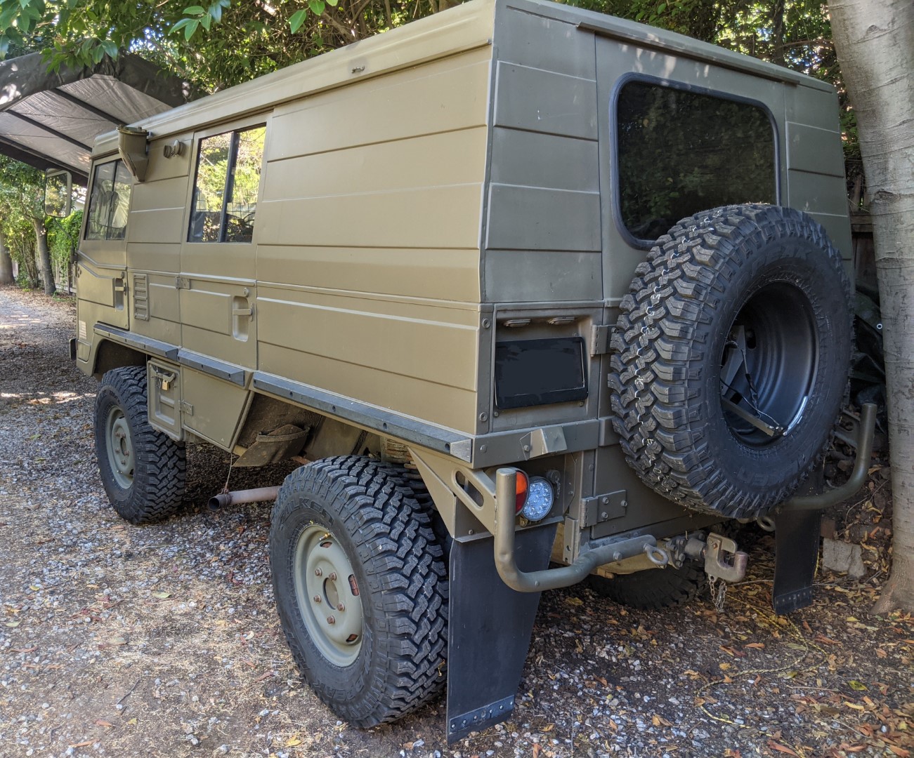

So...I mounted up the new tires and there were no perceptible vibration issues.
Also, speed numbers look to be 101KPH on the speedo, 4050RPM, 60MPH, with tires at 36PSI.
Handling is incomparably better than the original Swiss balloons that used to be on the truck.
