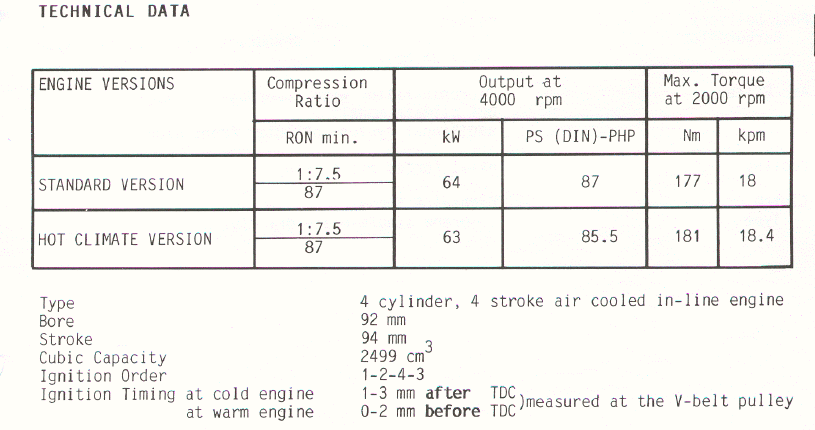

JimmyC wrote: Tue Sep 07, 2021 6:58 pm It seems like the stock compression ratio is pretty low, I guess to allow for for low octane fuel. Being that the lowest octane available here is 87 I would think the compression ratio could be raised without much issue. It seems like it would be easy to do, just shorten the jugs a bit. Has anybody done this? If so, how did it work out?
The manual calls out stock compression ratio as 7.5:1 and the RON min as 87.
