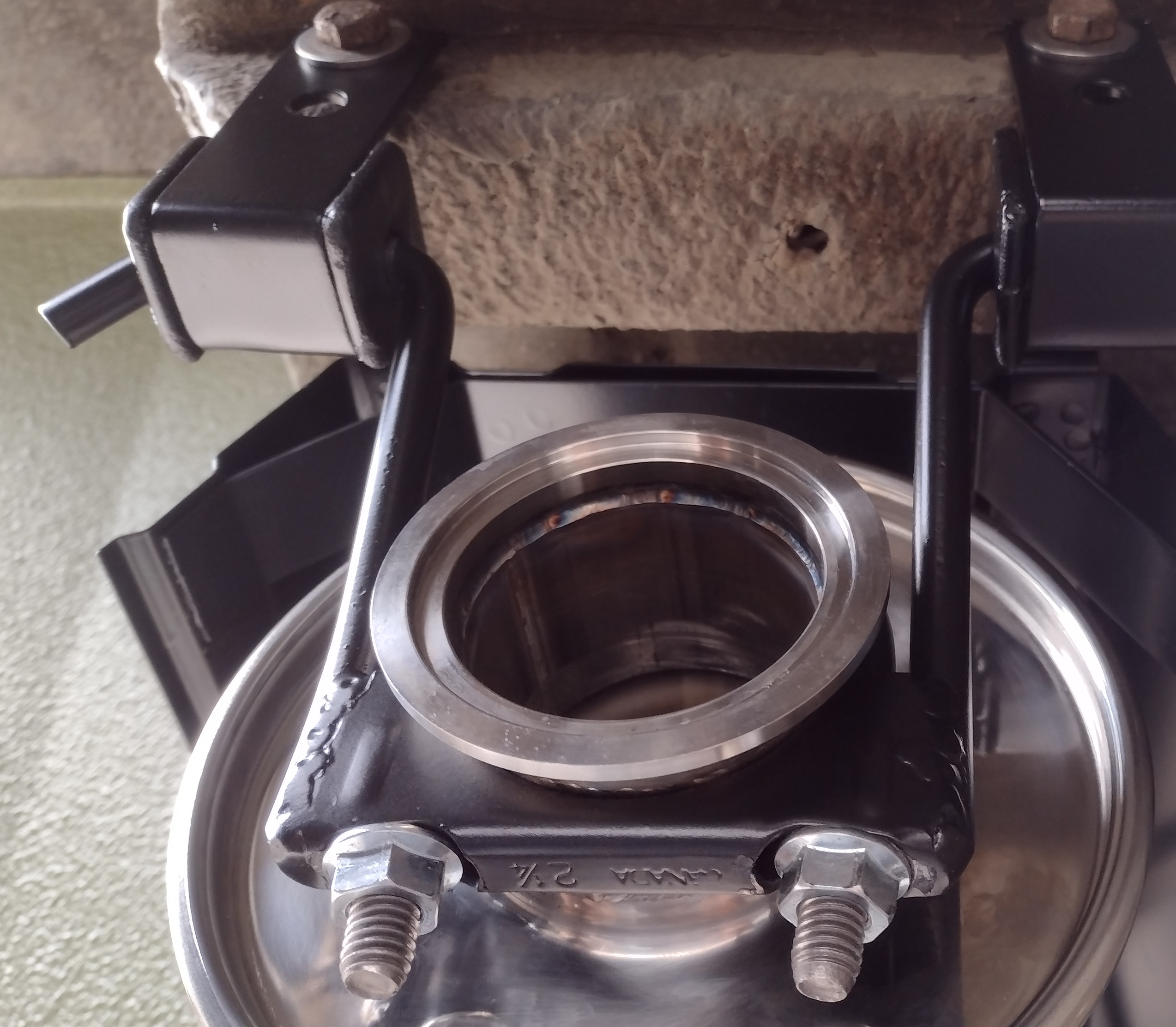

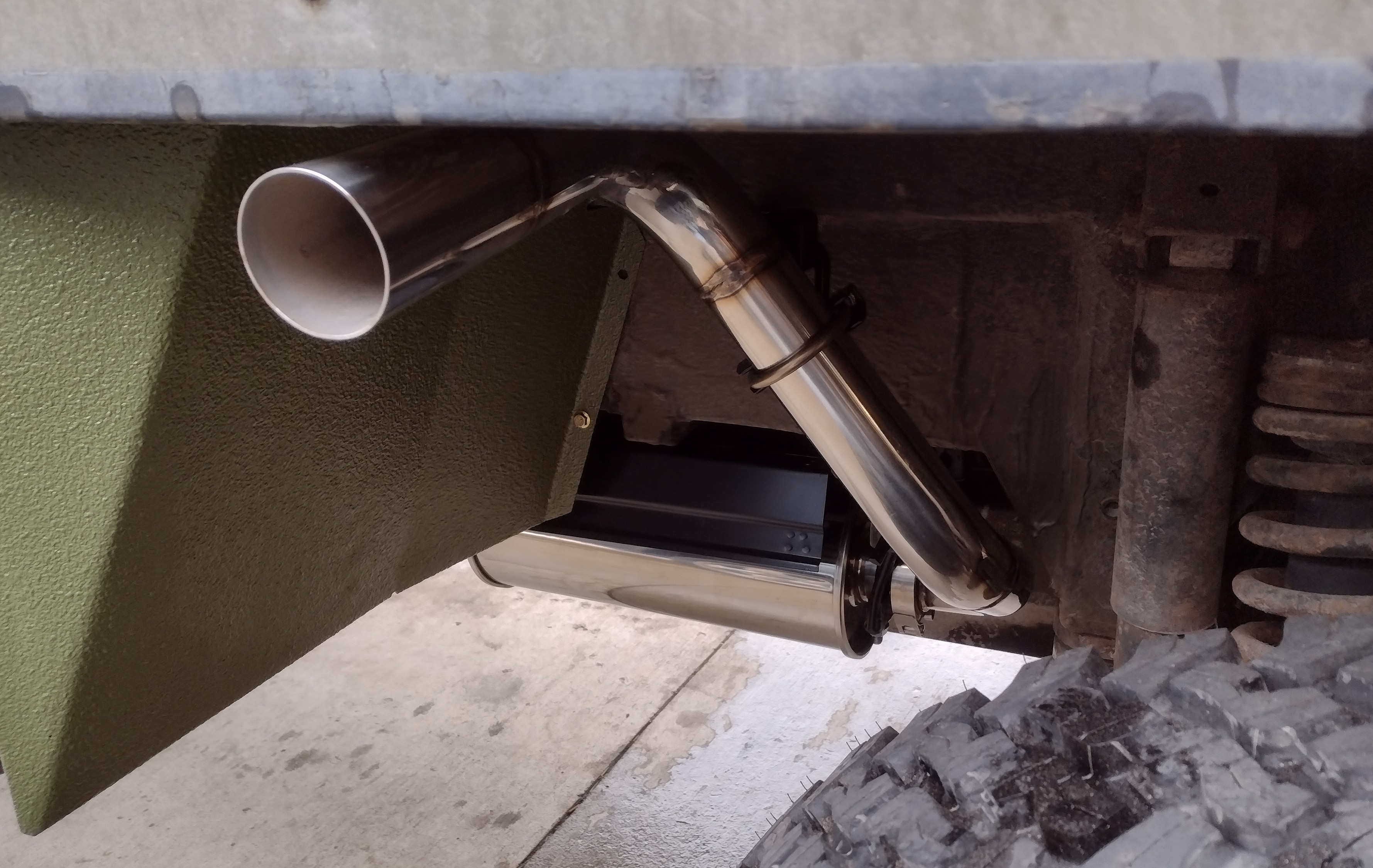

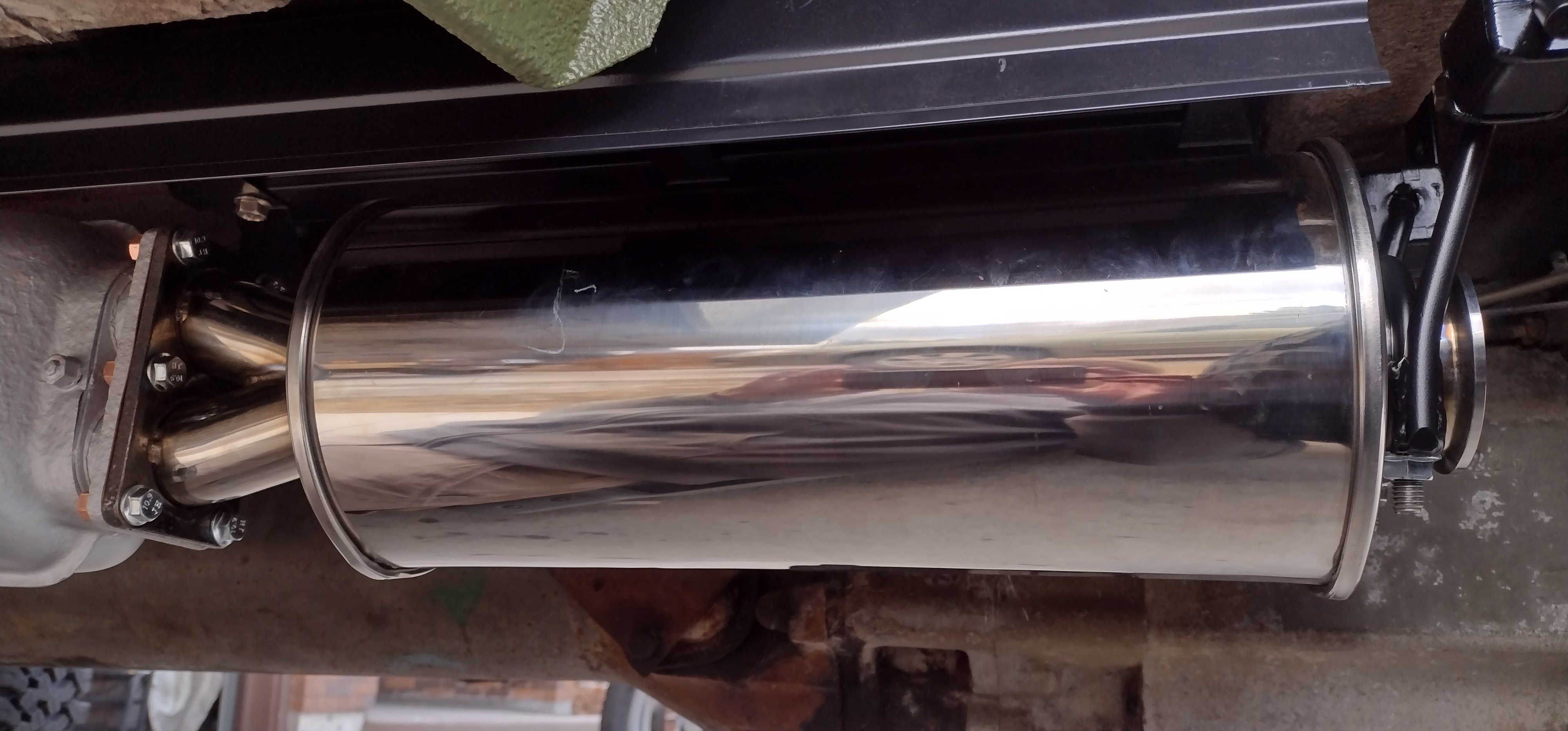

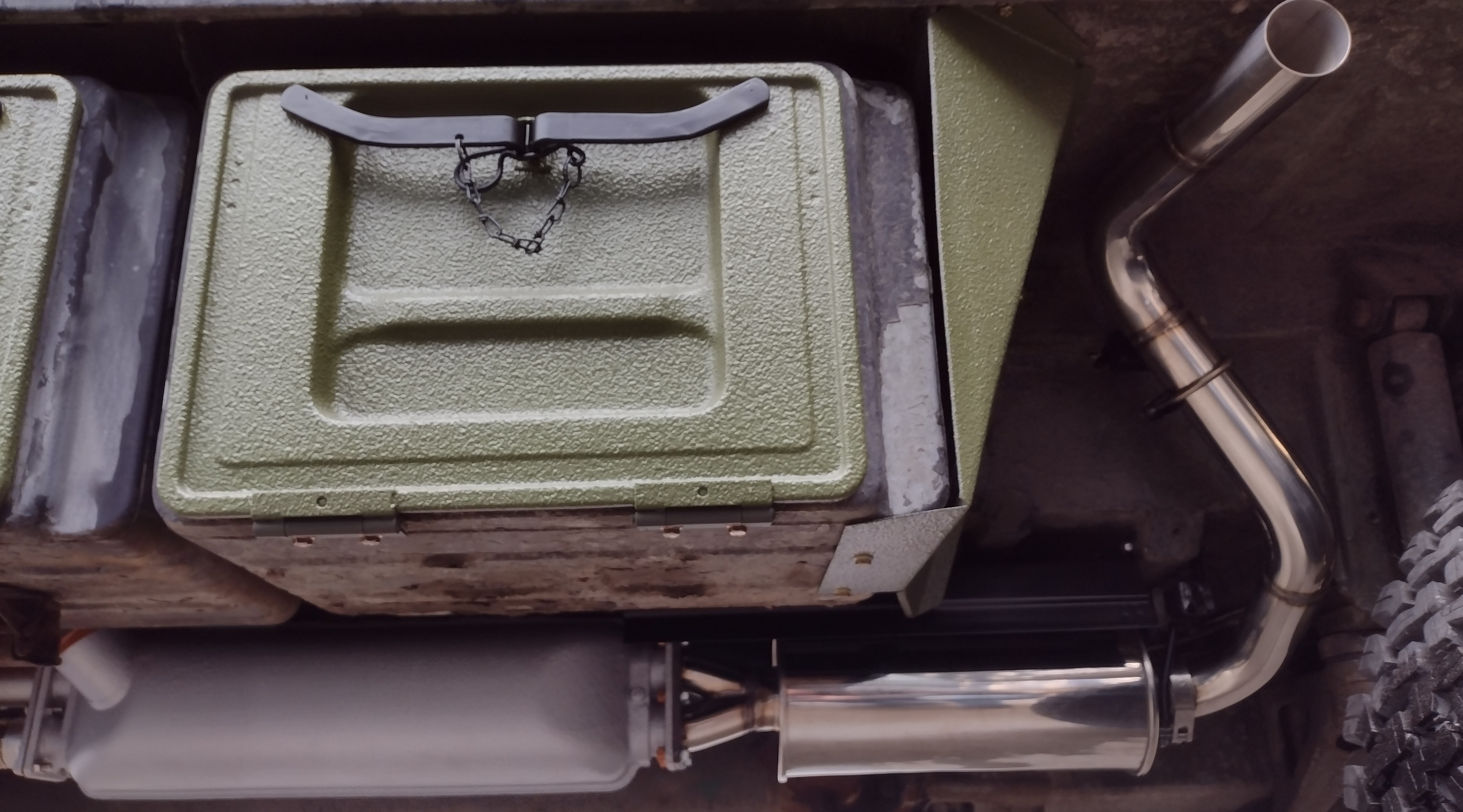

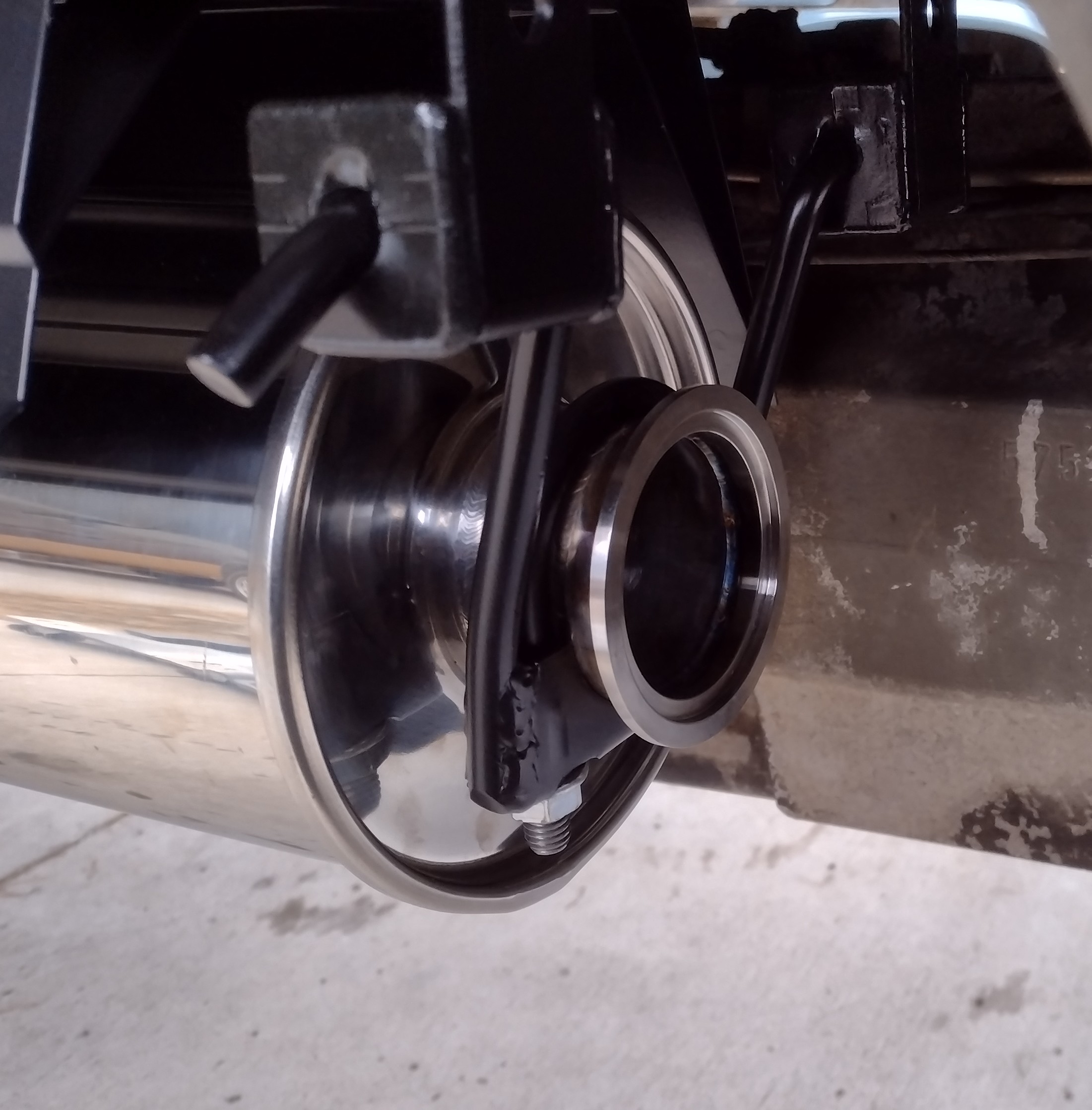

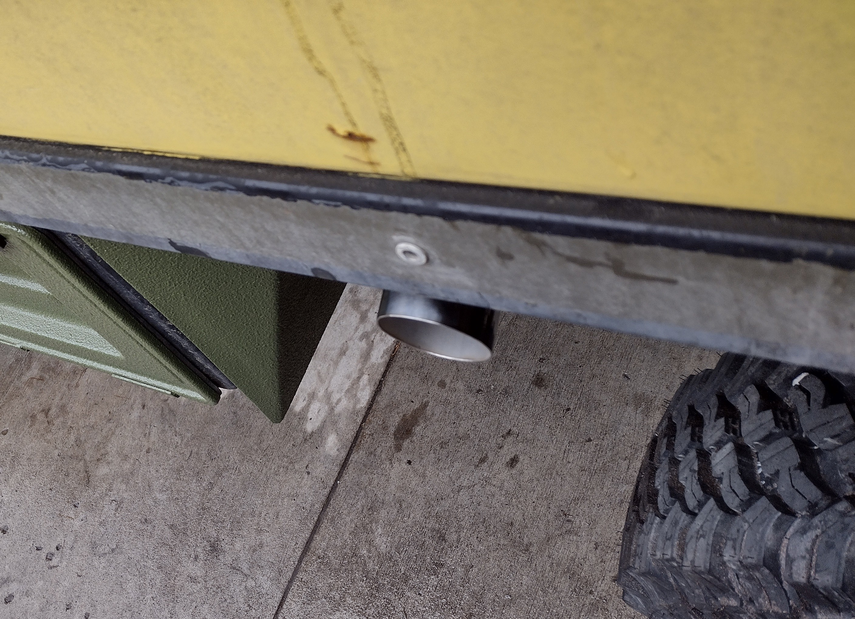

My 710 came with a muffler in poor health so I finally decided to do something about it. Inspired by the grainy photos found online I made my own high clearance exhaust that exits behind the storage box on the left side of the Pinz.
It's 2.25" throughout with a dual 1.75" to single 2.25" transition at the head of it all. Despite the smallish straight through muffler, it's damped well and cruises quieter than the now evident geartrain noise. It can get loud if you want it to though which seems to work well with my beast.
I wanted to try the high clearance first, then will probably do a different tail section with a full length exit once I get a season on this one, or when my kids start choking on exhaust. Not sure what to really expect here.
Anyways enough rambling...here are some pics!
