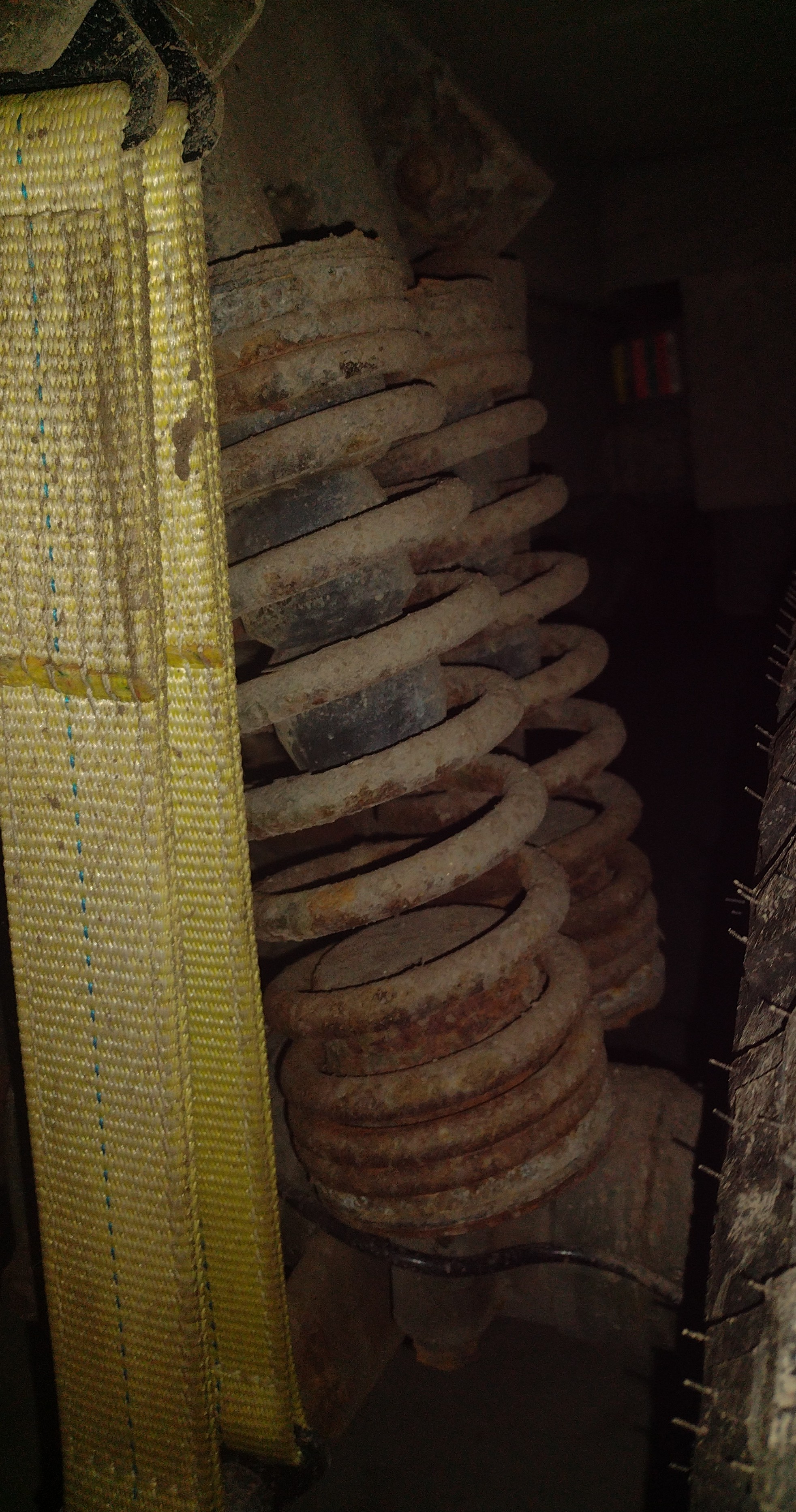

There were no discerning marks on the rear springs but the spring cup pins measure out to be around 135mm from the top of the bolt to the tip. This seems about right as my spring cups are fairly close to the axle, but that could also be because my cups are severely corroded!
Here's a pic of what I'm working with. The replacement limiting straps are the same length of factory straps I removed...I believe they were 17.5" eye to eye.

Hmmm, Ah Ha !! Well clearly those aren't OEM limit straps.
Looks like OKoffroad Nylon webbed. For the Pinz, these straps
are sold with a recommended length of 17.5" C-to-C. They can
be ordered to lenght, sooooo....if yours are short they can be
replaced with the recommended 17.5" or if that's too short then
a custom build can be ordered.
Here's a link to their site https://okoffroad.com/stuff-susp-limitingstrap.htm

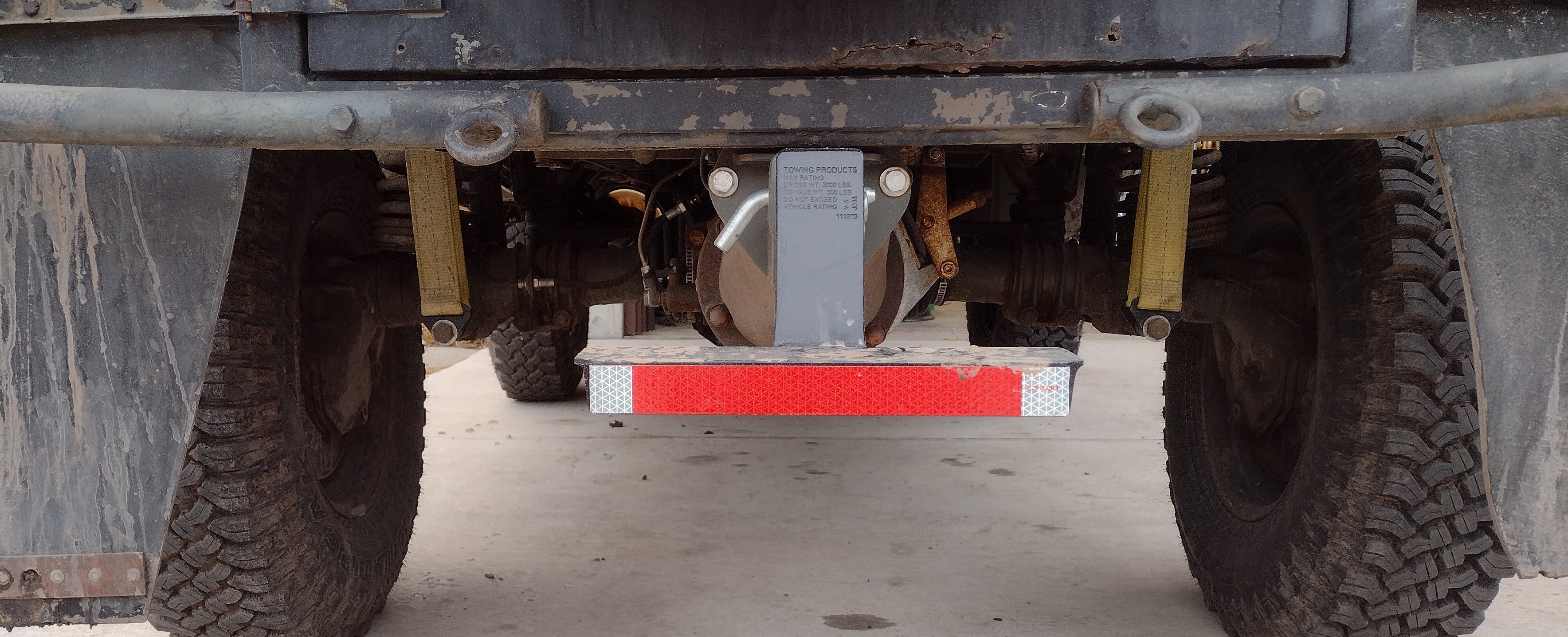

BTW that duo of garaged Pinzie's is yours truly -- I DO NOT use synthetic straps.
I do get my recovery gear from OK including Ramsey winches. Didn't know this PIX
was on their site in that section 8)

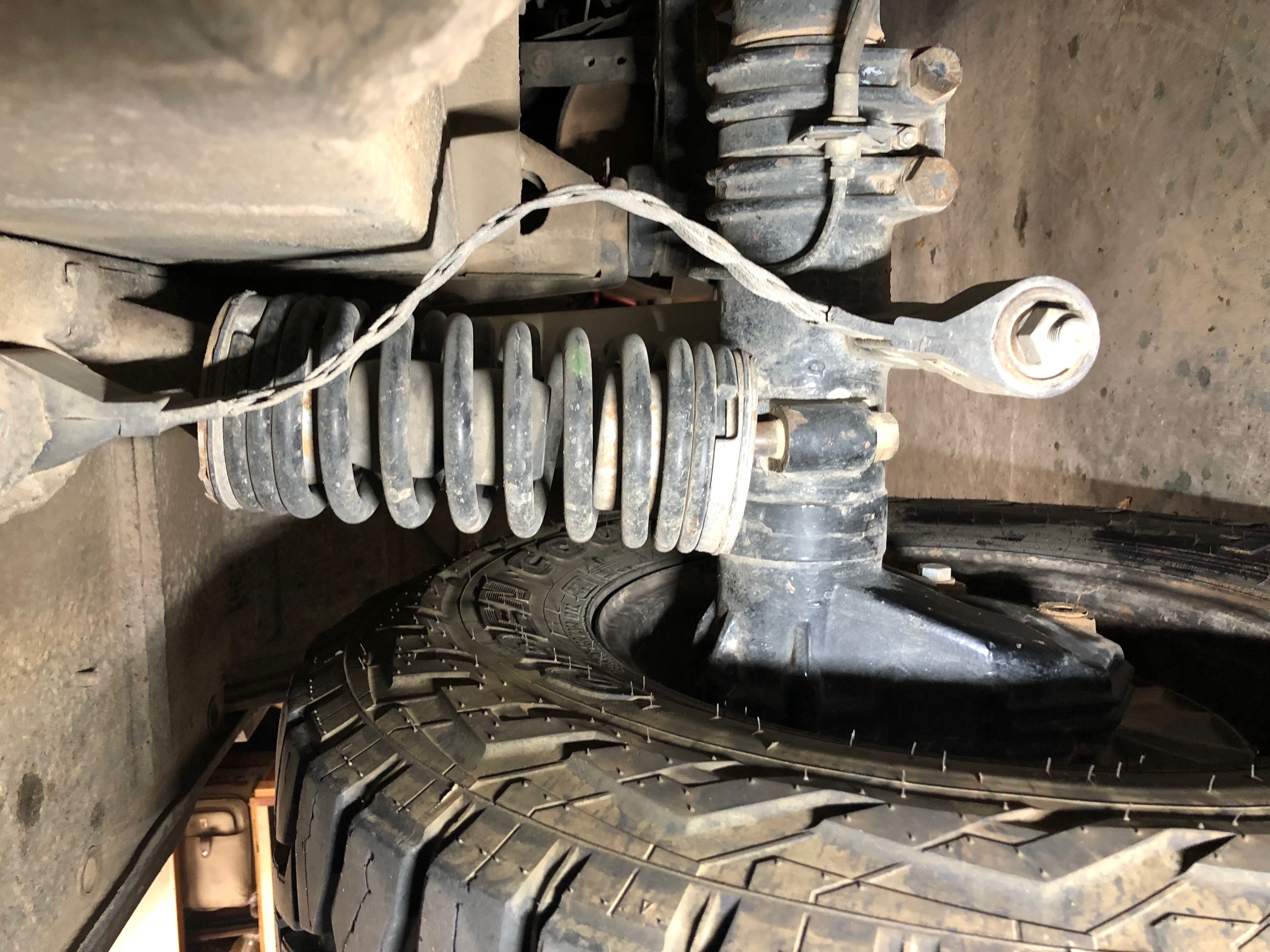

I have included a PIX of my 710K rear end, no significant load in the rig.
Also of note my springs are new, mid-strength. Total of 11 turns.

So the OE rear limiting straps were snapped in half when I first got the Pinz, so I went ahead and replaced them with those OKOffroad ones. I verified the length of the old to what OK offered and they were the same. No complaints with them so far, they seem to be doing a fine job.
My Pinz is nowhere near as clean as yours, nor will it ever be lol, but here's a better shot of where I'm at.
You can see the distance between the bumps and lower cups are greater on mine. It also seems like the coil count is the same...hmmm. You can also see that my lower cups are kaput! But look at that shiny new hardline, oh yeah!

Unlike the front suspension, I don't think there are pin length options
for the rear. Although 135mm seems a bit long? Did OK send you the
proper length straps? With them fully extended should be easy to measure.

So the straps are indeed 17.5" eye to eye. The springs, measured from the top of the cup to bottom of the cup come in at 11.5", so 1.5" longer. This would explain the difference in ride height that I'm seeing from front to back.
If my pins are about right, the straps are right, but my springs measure different, that can only mean the springs are too long correct?
Are the springs on a 716 different lengths and swap in? The history is vague on this one so who knows who did what.

Joeri brings up a point worth looking at. You can eyeball the Axle alignment, or measure
the 2'nd spring length. If the Axle is rotated one spring would be compressed while the other
extended. These springs are progressive so a compressed spring would have a higher KP value.
I am more suspicious your rig was fitted with the stronger springs. You would find 3 green paint
marks (now perhaps long gone) indicating the strongest spring, one mark for the weakest. To
put this in perspective, weakest spring value is 3590 Newtons, strongest is 3963 Newtons -- MEASURED
at 240MM, just under 10". I assume Steyr was thinking 240MM was under typical loading conditions,
not empty not maxed out.
If your Axles are true, then that leaves replacing the springs with weaker ones or cutting the ones
you have down, e.g. take a 1/2 turn off each end and see where that takes you. I have a spare set
of springs that were cut down as such -- long history with these springs. Last set of springs I got
from SAV were 2 green marks -- mid strength.
