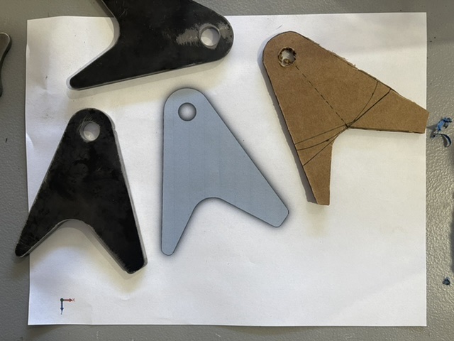

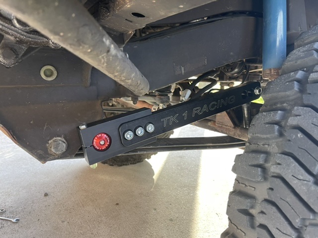

Just thought I would post this for anyone interested. I have found my 2 leaf parabolics to be excessively soft after working them fairly hard. My truck has excessive body roll that just makes it uncomfortable to drive regularly. And since my C303 is just short of my daily driver I had to make a change. I was considering changing back to stock springs or over valve my shocks (helps but is not a real solution). I even considered air bags and maybe an add a leaf. The add a leaf would probably be a pretty good solution but I ended up choosing to go with a sway bar as it would cure my roll and not add any ride height. So long story short I added a TK1 Racing 36” crawler rate sway bar. This requires minor fabrication skills and maybe some light machine work at the end of the day to clearance a part (haven’t done that yet). Anyways, the sway bar has made the truck much more enjoyable to drive regularly and honestly much safer. Here are my two lame pics. The last one is the lower tab I had to design and weld to the axle housing.
