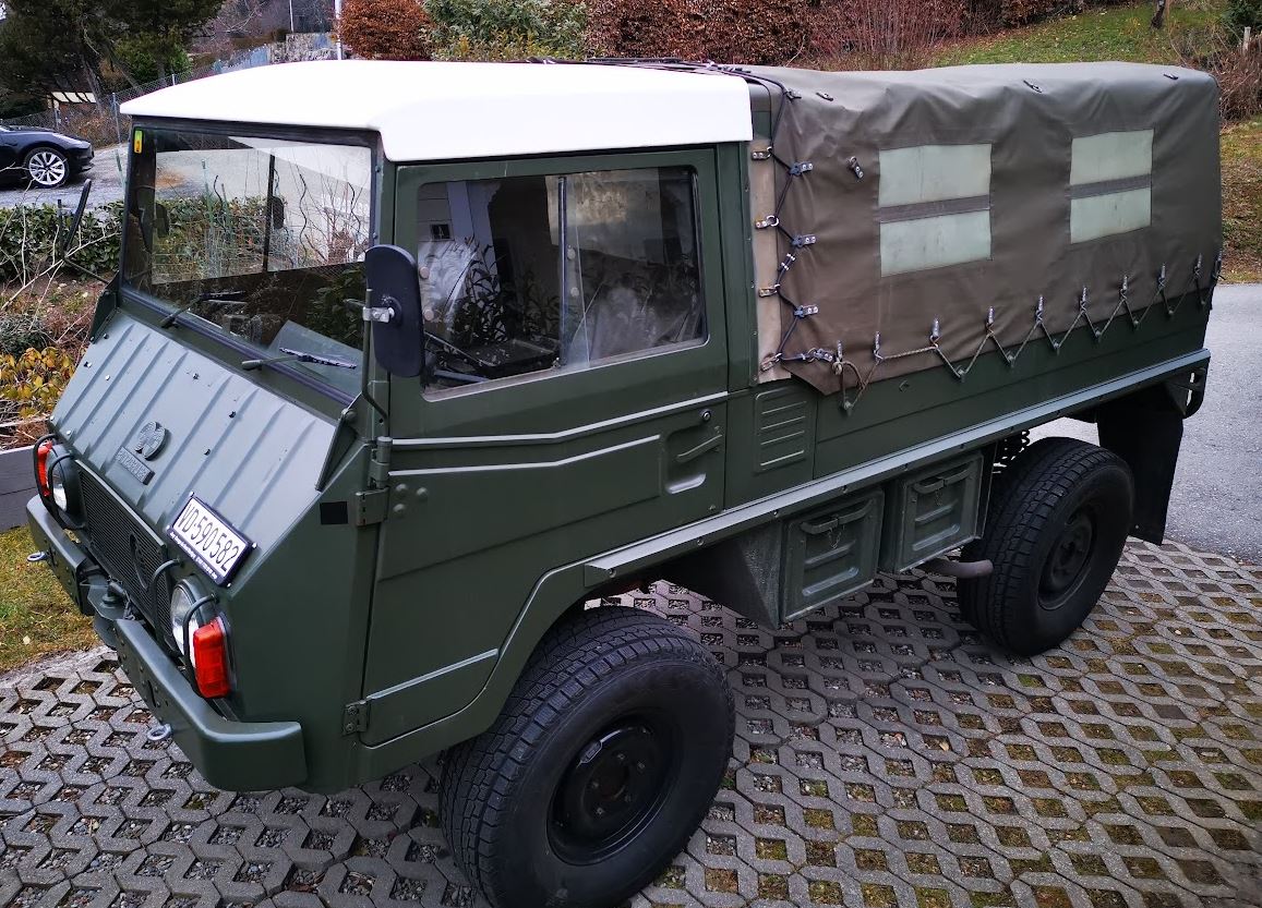

Test fitted my new hardtop today,
It's rather easy to install, there is a lip up front that catches the metal hook where the tarp straps in.
Then you drill on each side at the back to bolt it to the B pillar.
I still have to find a way to mate the hardtop to my box, to avoid water ingress.
I managed to keep the central U bar, so that it can support the weight of my storage boxes on the roof.
It weighs 11 kgs, but you remove about 5 kgs with the tarp and hardware, so net weight increase is 6 kgs.

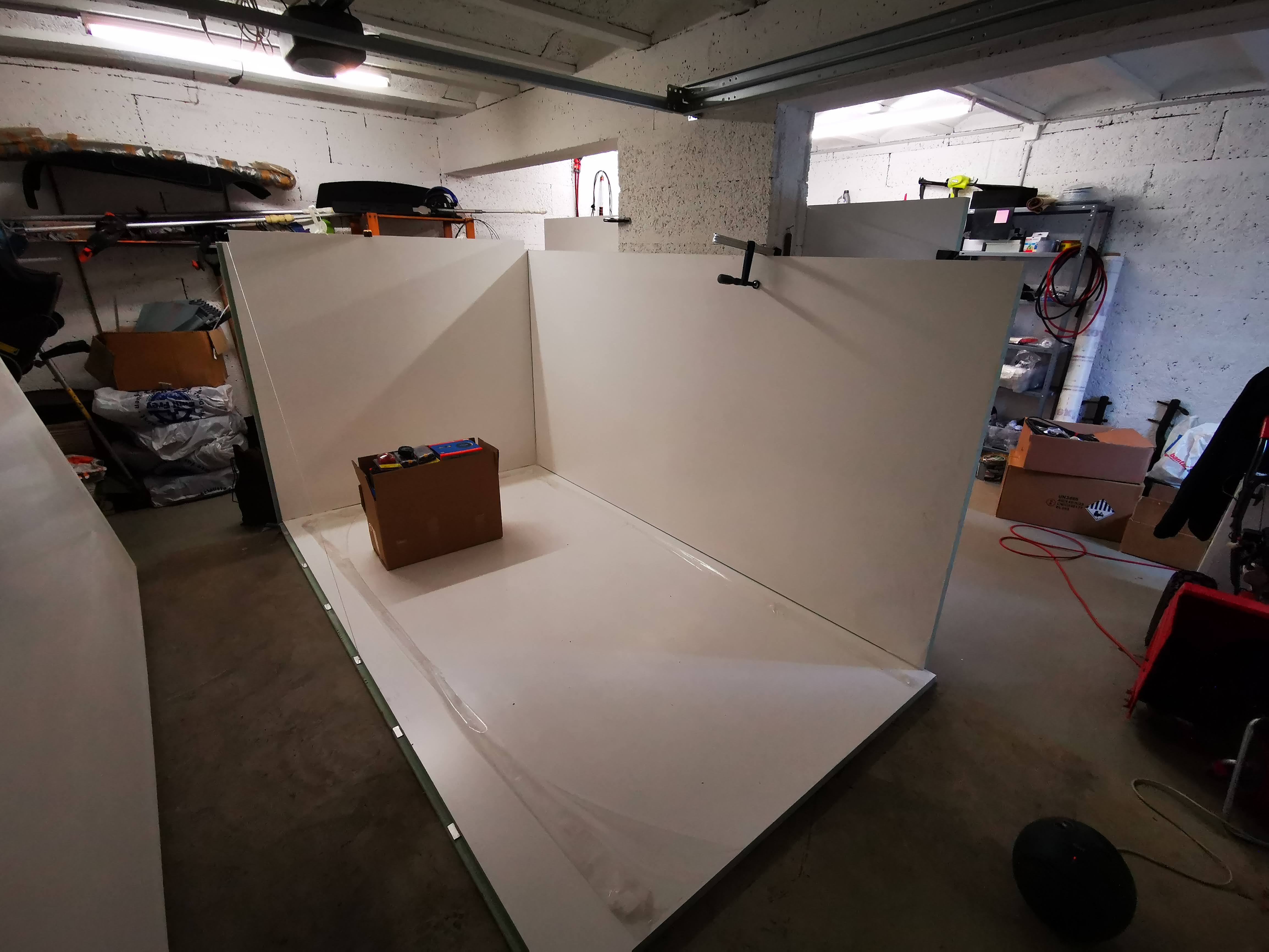

Little update,
received my panels for the box,
test fitting them in the garage,
removed tarp, structure and panels from Pinz

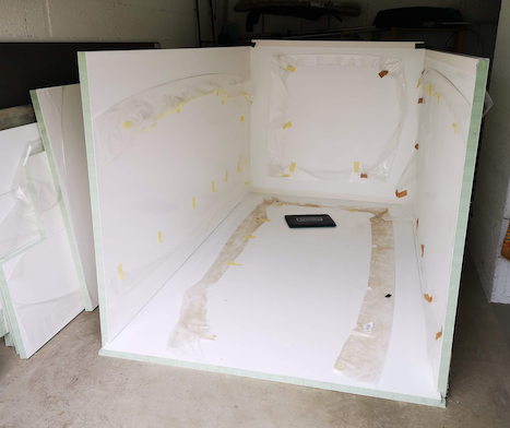

A quick pic from this afternoon,, just test fitting the front panel:

So, I started to glue the first panel, in the garage, the box is upside down,
so the ceiling of the box sits on the floor.
I've glued the base of the front panel to the ceiling.
