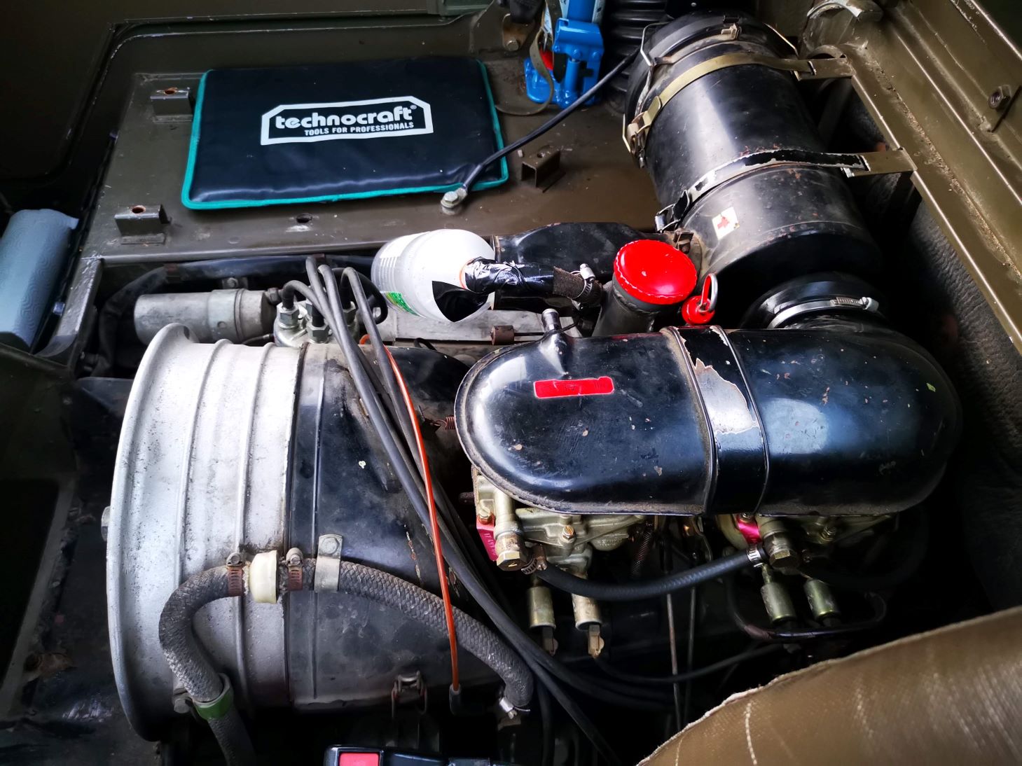

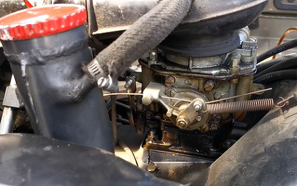

Hello everyone,
When I drove home from work today, I suddenly saw a lot of white / blue smoke coming from my exhaust when I was 60 km/h and in 4th.
I stopped and parked the Pinz for a few checks, oil level good, no special noise, no smoke when idling or driving in the 1st, 2nd, 3rd. gear.
So I slowly drove home and tried to reproduce the problem on the last strtech by going 60 km/h and in 4th gear and suddenly a lot of smoke again.
So drove home, turned off the pinz and thought a bit.
As you can see in the video, in my opinion oil comes from the front carburetor, but not from the rear.
So I removed the air inlet and saw oil directly after the air filter.
I think it's oil in the front carburetor, in the back hole, not in the front with the flaps ( sorry, I'm not using the correct words ).
Any idea what to do next?
Can this be a broken piston ring? Or does oil come back from crankcase ventilation if something like that? But why only the front carburetor?
Or is that maybe not oil that i see ?

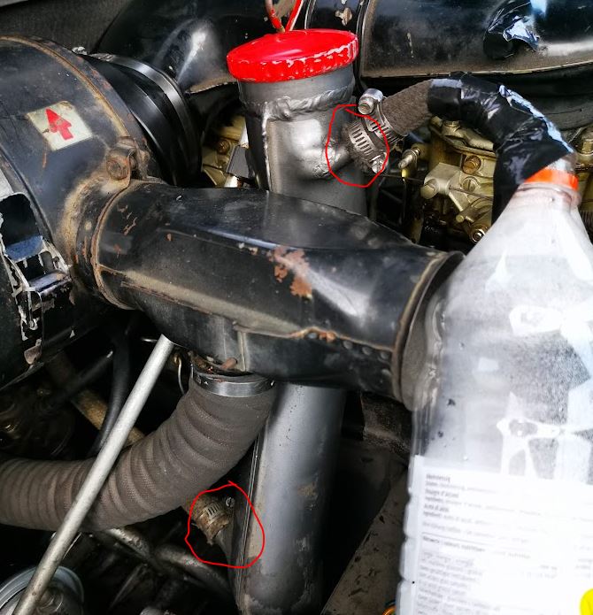

If we exclude a damaged piston ring for now, I would like to understand where the oil in the air inlet and carburetor came from yesterday when the vent tube was attached. How does the crankcase ventilation system work normally?
- The vacuum of the engine sucks the gas out of the crankcase ? or is it the pressure in the crankcase that pushes the gas into the vent tube?
- If it is the vacuum of the engine that sucks in the gas, then it is normal that I have no oil in the bottle, right ?
- How can oil get into the air inlet and carburetor through the vent pipe? Is anything clogged? I have greasy residues in the oil filler pipe. Can they clog the ventilation system and instead suck in the vacuum oil from the engine?
- What is between the ventilation pipes shown in red in the second picture? Is there a sleeve around the oil filler pipe to collect the oil droplets in the crankcase gas so that they can fall back into the engine ?
If I knew how these tubes are connected, it would make it easier for me to clean them up.

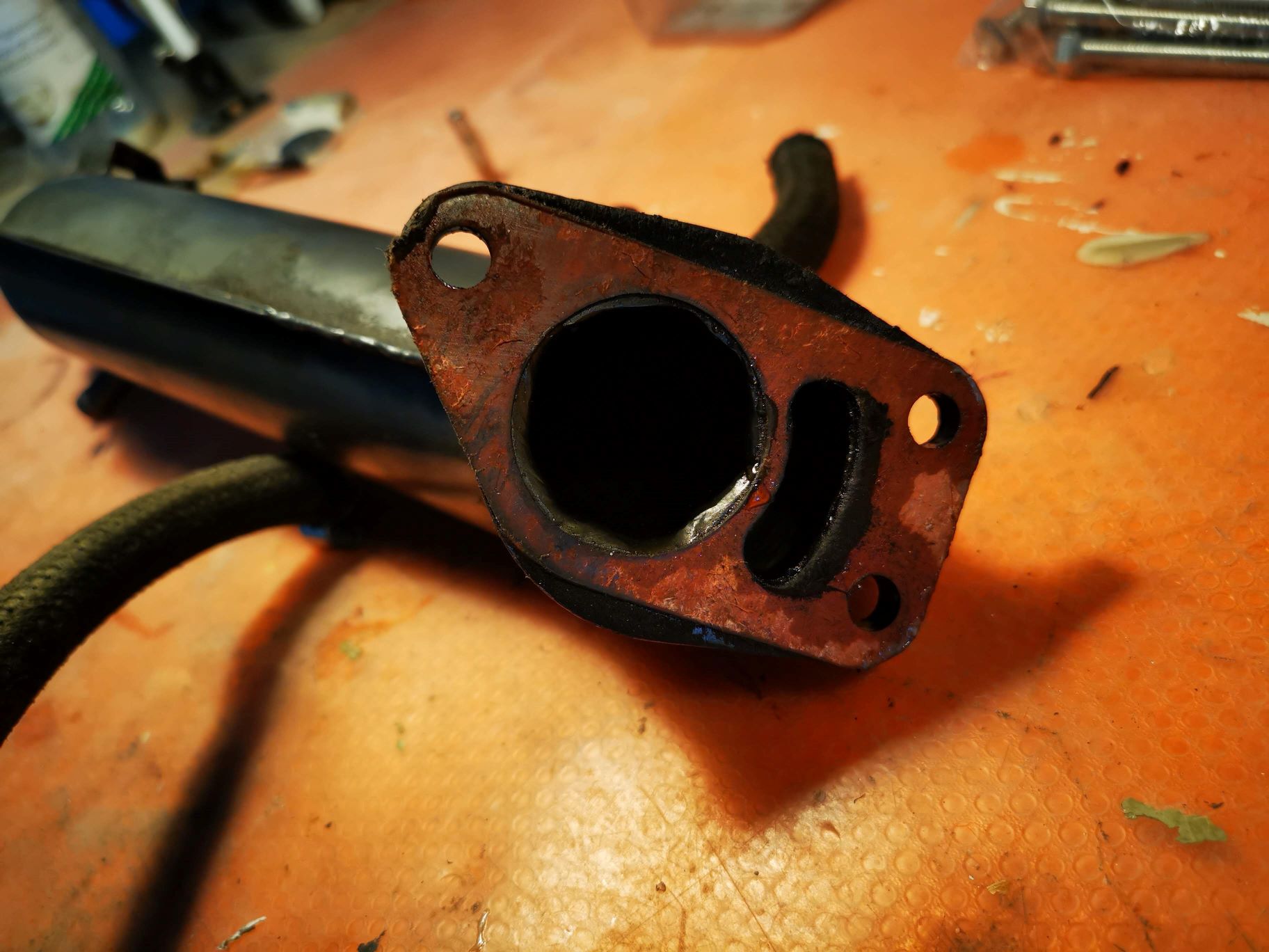

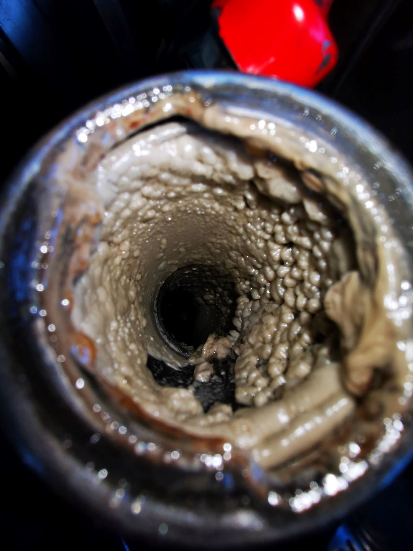

Ok, so I removed the oil filler pipe and the 2 vent hoses connected to it.
Quite a lot of greasy white stuff in the pipes, given some WD-40 and then rinsed with air and a rag.
Good to know how the oil filler pipe is constructed, see picture below, there is a sleeve around with 2 openings below,
The round is where the new oil flows into the engine, and the other bow is the sleeve that is connected to the 2 vent hoses.
So I assume that the goal of the sleeve is to collect the oil droplets from the crankcase gas so that they can fall back into the crankcase.
Then I reassembled everything and did another test drive longer than in the morning to ensure that the engine reached the travel temperature.
I haven't seen any smoke, the engine works normally, performance and noise as usual.
So it seems possible that the oil I saw in the air inlet and in the front carburetor came out of the crankcase ventilation system because its parts were clogged. I will continue to drive the pinz and watch the situation, especially signs of engine oil in the air inlet.
I will order new vent hoses and the seal for the oil filler neck, they are quite worn.
