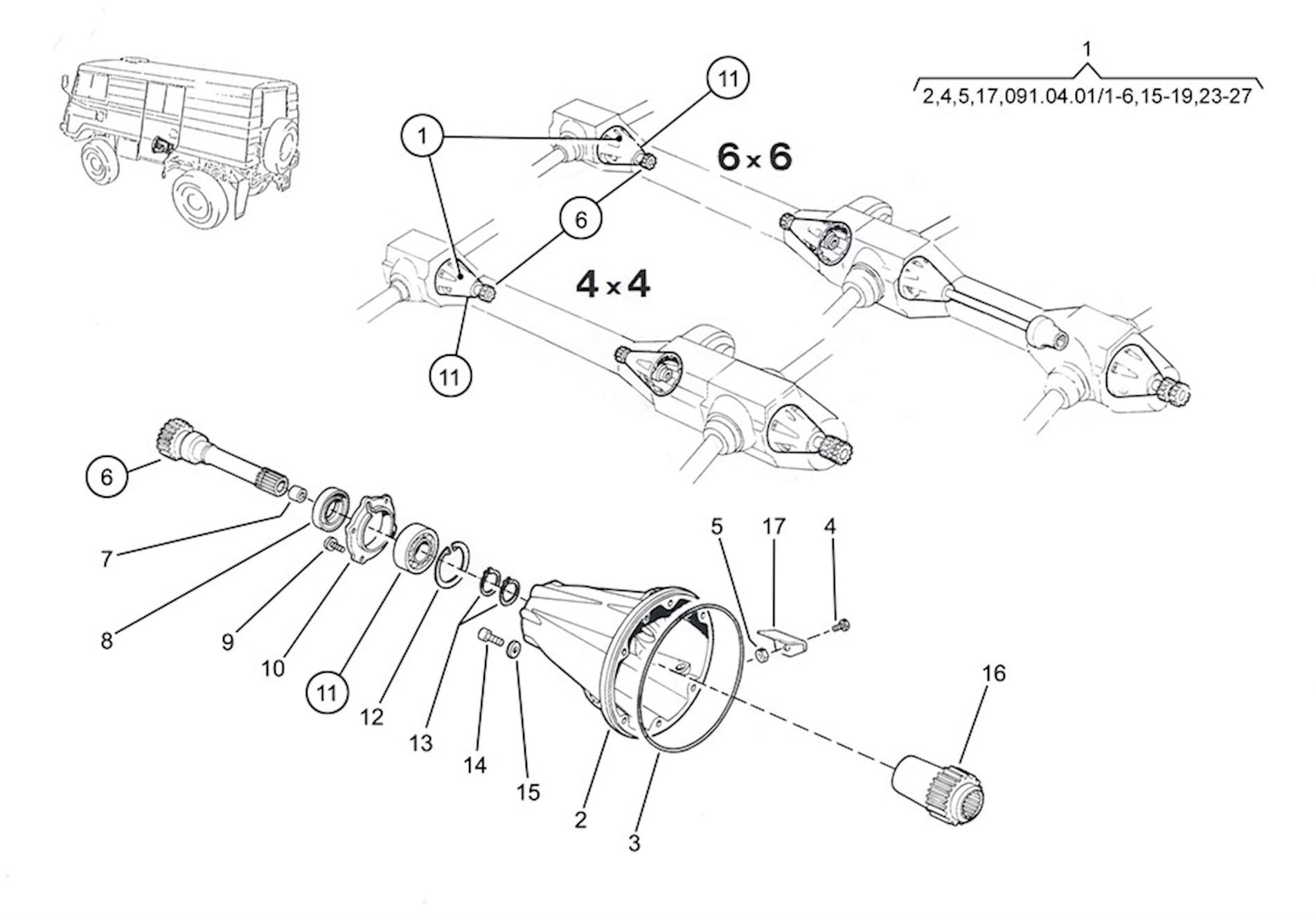

It's not normal, but I think most of the pinzgauers have at least a bit of oil in the Central tube.
O-RING 179-3C/69 (9023776 - Number 3 in the picture) or SHAFT SEALRING A42X55X8-VI 468 (9023860 - Number 8 in the picture) are leaking in this case.
As it's a pain in the ass to change them (you have to pull the axel) i would first try an oil leak stop additiv.
