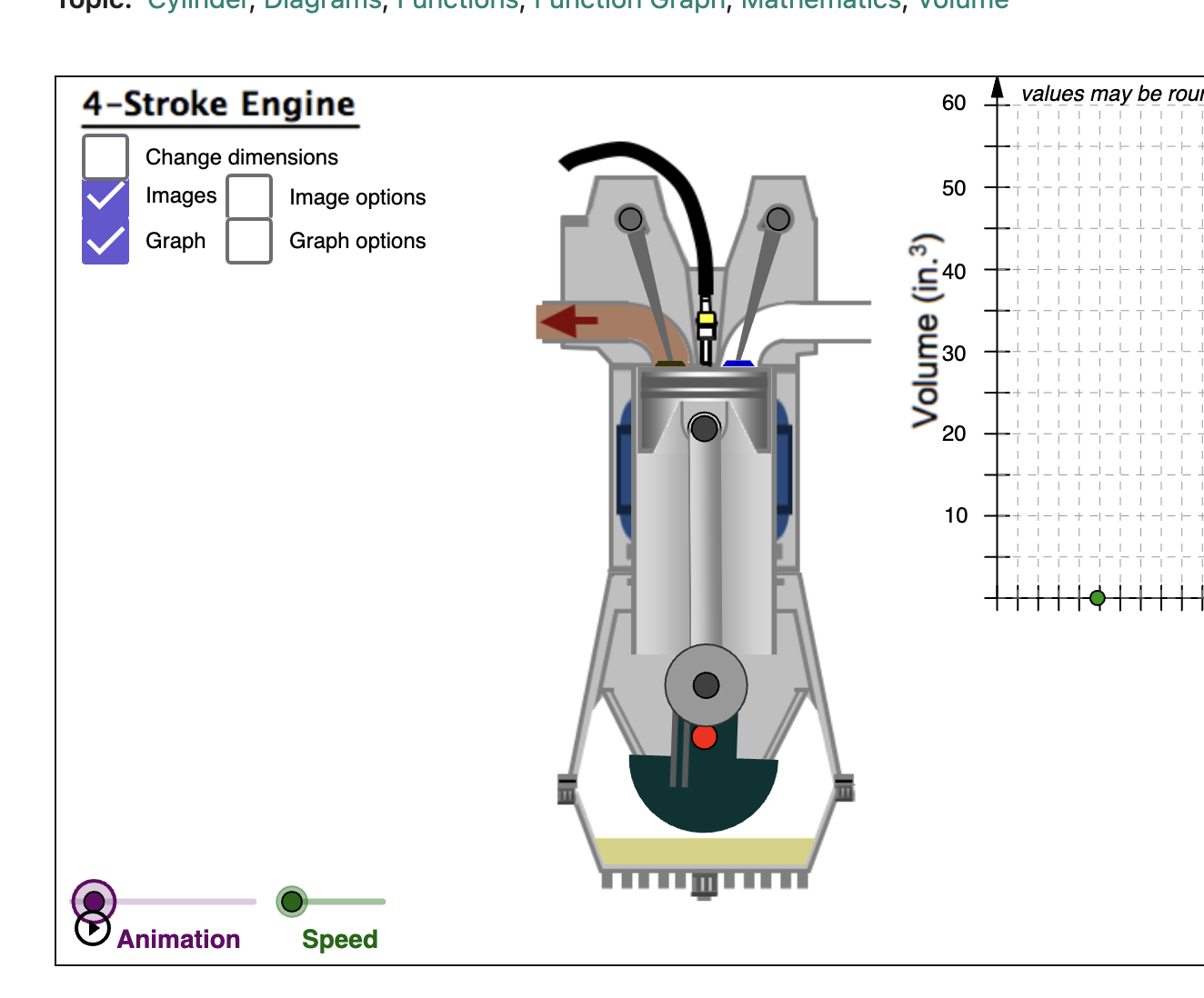

I think the overlap position the Pinz manual is referring to is the following:
"the overlap position for a given cylinder is when its exhaust valve is almost closed, and the intake valve is just starting to open."
This is the position you can see near the beginning of this online simulation:
https://www.geogebra.org/m/fmhfXxu9#material/fCHTsj4R
and pictured below:
I have managed to adjust my valves today, a few were around 0.3mm rather than the 0.20mm prescribed in the Pinz manual.
And indeed, when you place cylinder 1 at TDC, cylinder 4 valves should overlap, as described above, so exhaust valve is almost closed while intake is starting to open, this is what I observed on my Pinz.
