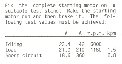

Bench testing was done using the pinz battery stack. 80A inrush current, and 30A running current -- does anyone know if that's typical? Mine is Rev1 (the longer one) starter.
Solenoid seems to drive reliable, with no failures noted after a dozen or so cycles. Even on a 10A-current-limited power supply, the solenoid engages (but starter doesn't spin due to insufficient current and a drop to about 2.5V at 10A). Seems to engage fine on the dual-battery stack of the truck.
No obvious signs of issues on the drive teeth, ring gear teeth, or the rubber mount. Pictures attached for more expert eyes.
Is the current typical? The manual calls out 42A, so mine is a bit lower, but no range is specified. Ideas for next steps?
