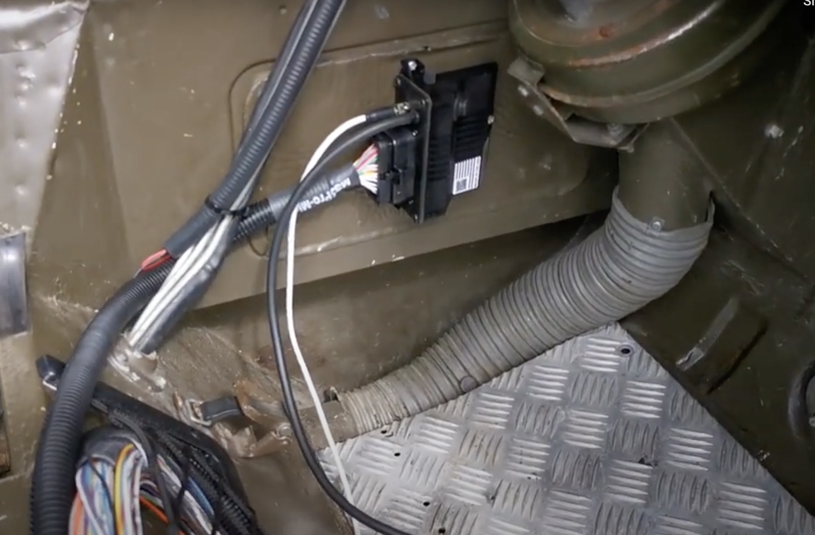

I installed it today and connected it to my laptop,
the only data i have for now is Manifold Air Pressure, as can be seen in below video,
I will install a trigger wheel on the crankshaft pulley, wideband O2 sensor and temp sensor.

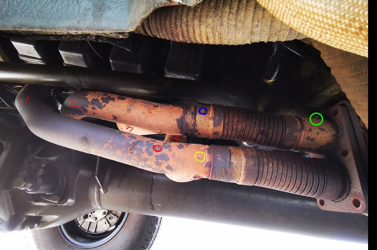

Curious.... Where did you install the O2 sensor?
Hugues
Posts: 189
Re: Megasquirt MS3Pro Mini ECU
Post by Hugues »
rmel wrote: Wed May 15, 2024 9:20 am Curious.... Where did you install the O2 sensor?
Yes good question,
On the green circle below.
Right on top of that pipe, 12 o'clock,
Had to be at least 60cm away from engine exit.
And this way I measure the combustion of both carbs.
Had to remove the exhaust between the engine and the heat exchanger to weld the bung, a bit of a pain.

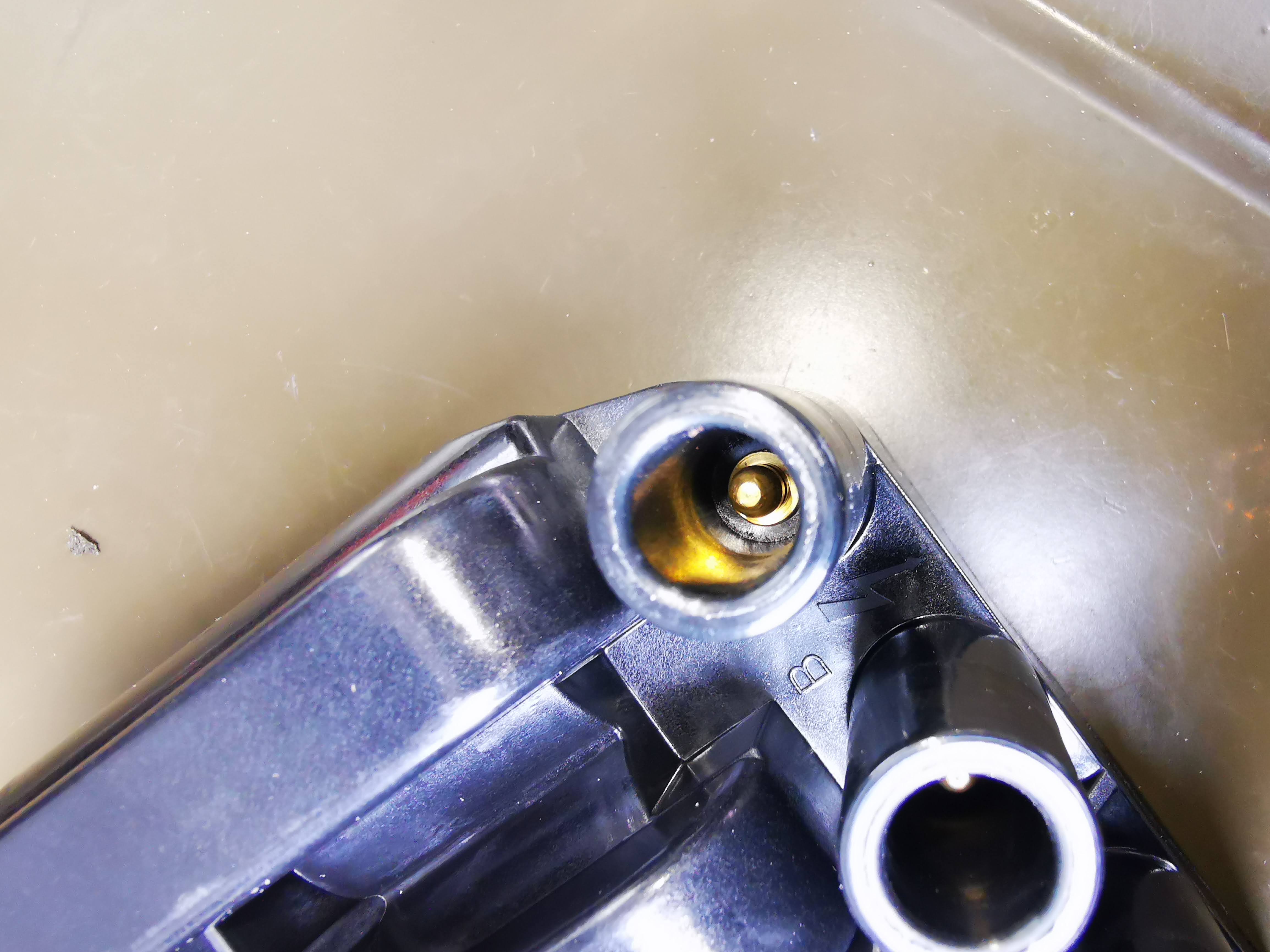

Received my new coil today, to use with my ECU to control advance.

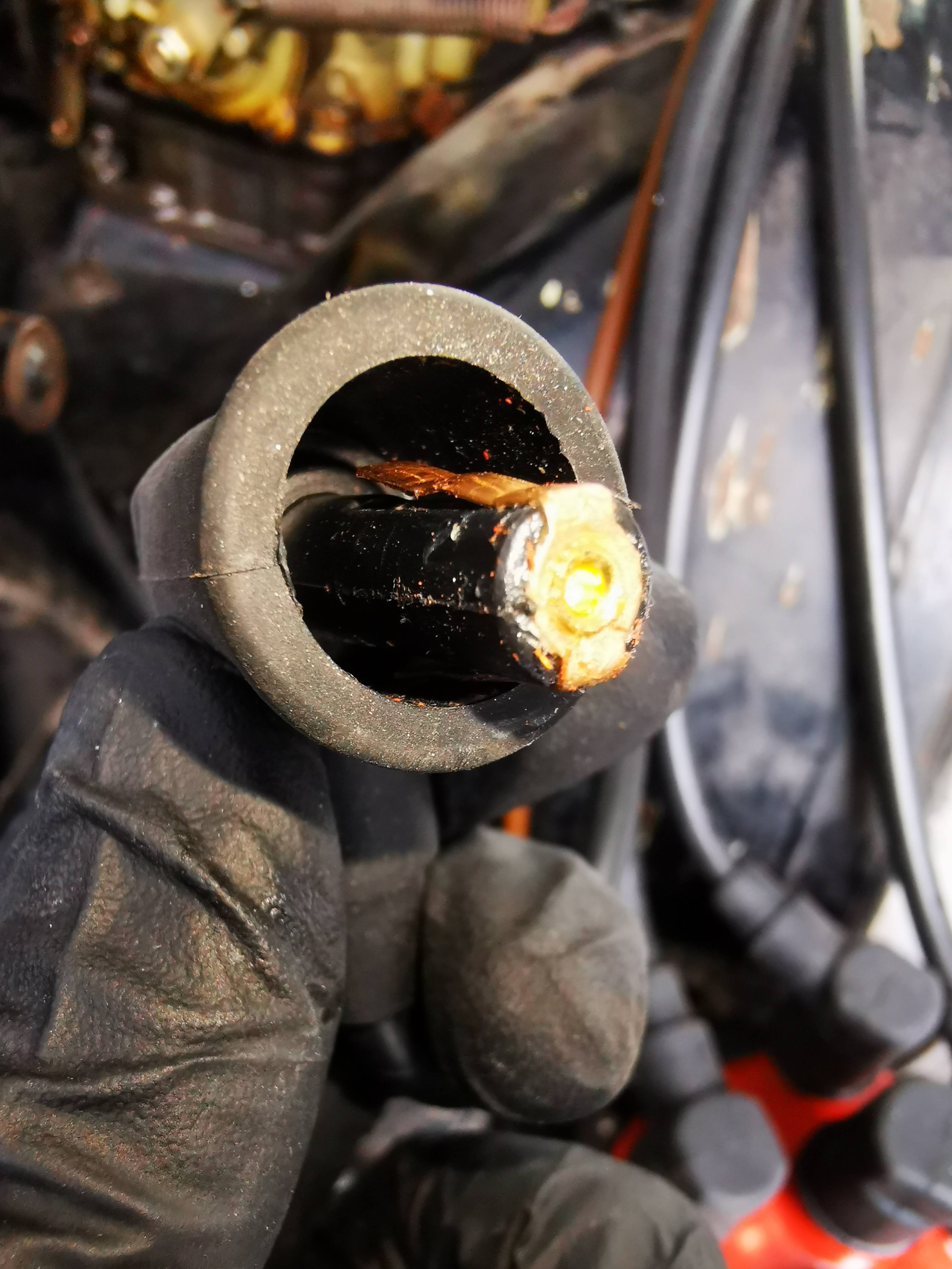

Little connector problem. I have the civil ignition spark plug cables, on the distributor side, it's a male connector, see 1st picture below.
But on my new coil there is a different connector. The rubber cap fits onto it, but inside it's not a female connector but a male connector.
Technically the tip of my current male connector would touch that male connector pin on the coil, but that does not sound like a good idea.
Anyone knows what kind of connector is this on the coil side ? I could buy or build an adapter, but not sure what to order.
This is the coil I bought: https://en.ridex.eu/product/8055482
male connector on the spark plug cable
male connector spark plug cable.jpg (604.84 KiB) Viewed 9769 times
coil side, male connector
male connector coil side.jpg (545.64 KiB) Viewed 9769 times
Hugues
From Switzerland
Posts: 2128
M4 connector?

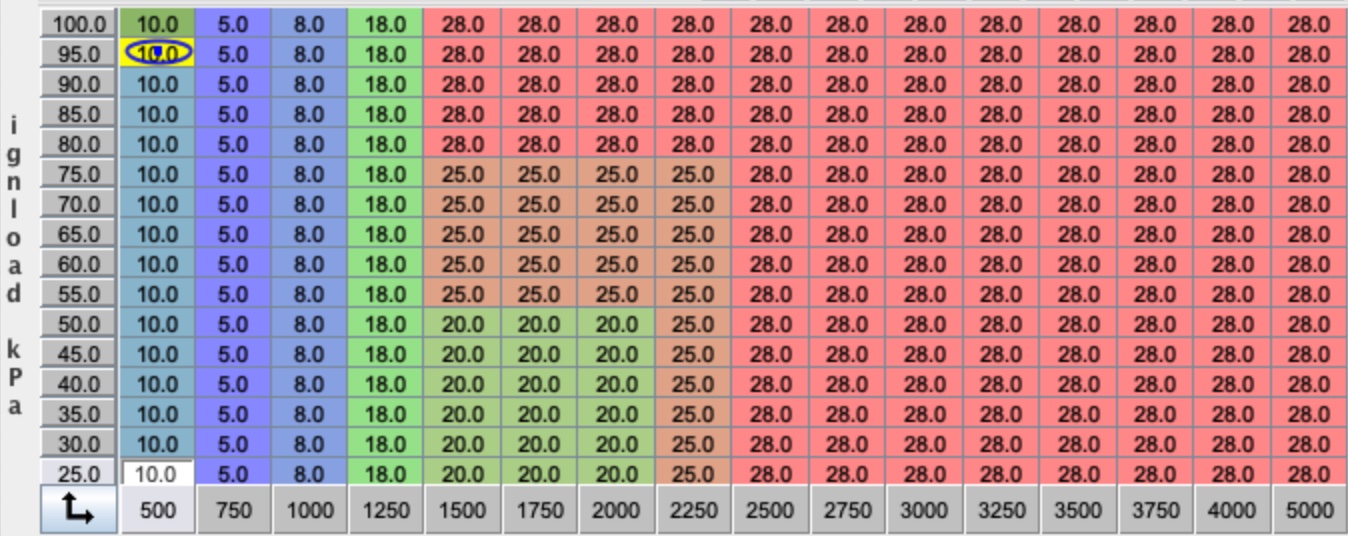

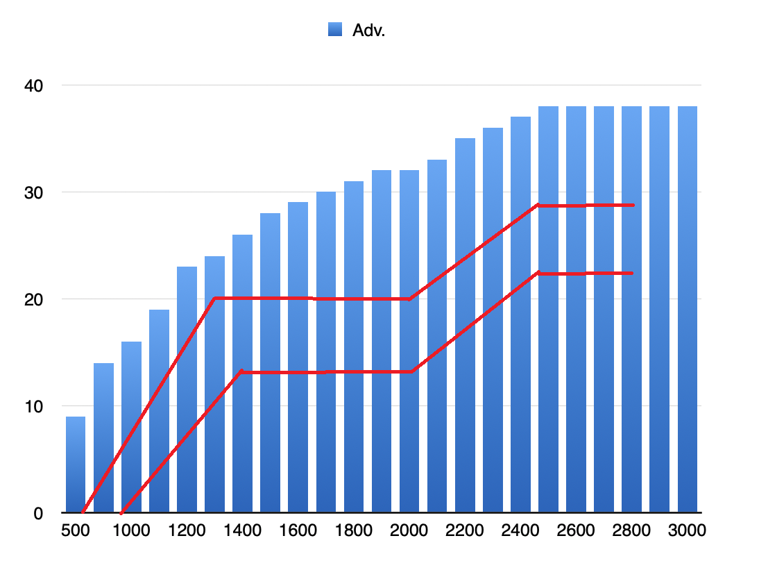

So my idle advance was stable so I decided to give it a try.
I first built the advance table based on the Pinzgauer manual, so purely based on rpm, not taking into account engine load, red corridor on bar chart below.
It ran ok but when starting to go uphill at mid rpm i had a bit of backfiring through the air intake, so probably firing too late.
So i then adapted my advance table to take into account load, but always stay with the Pinz manual red corridor.
Backfiring is now gone. Only impression is that power could be improved under load going uphill.
Should I push my advance beyond 28 degrees in these conditions (under load going uphill) ? 32 degrees maybe at first to see if it makes any difference ?
Running unleaded 95, at around 600m altiitude / ~2'000 ft
I show the advance chart shared by @rmel in this thread:
viewtopic.php?p=93655#p93655
edit: after a bit of reading, i might have modified my advance table in the wrong way, looks like for a specific rpm, say 2000, as engine load increases (less vacuum), advance should decrease. My table below would be wrong then...
My current advance table:
advance map.jpg (296.36 KiB) Viewed 9368 times
advance chart used by rmel , under load
advance rmel.png (296.04 KiB) Viewed 9368 times

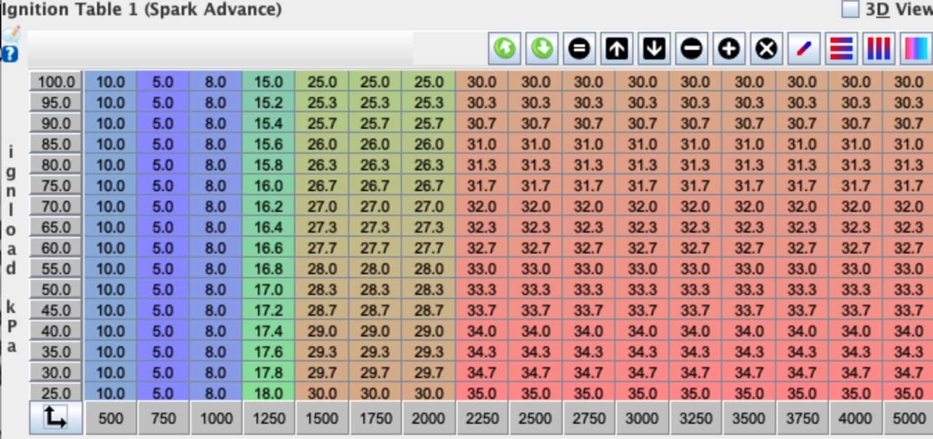

Just to update this thread if ever someone goes the same way,
This is the ignition table i've been running with these past 2-3 weeks, looks good, could be tuned better, but good enough for now
ignition table.jpg (315.11 KiB) Viewed 8545 times
