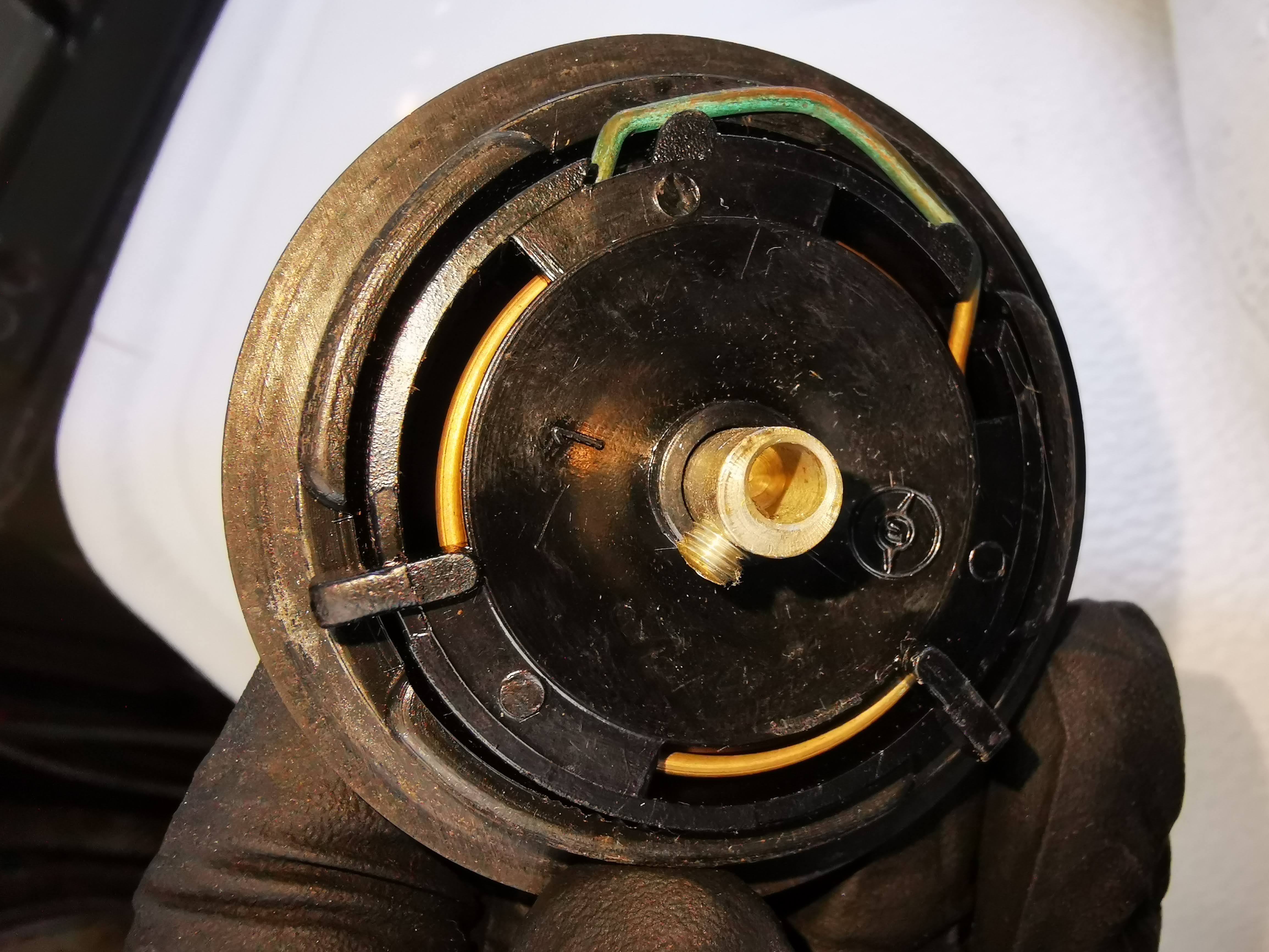

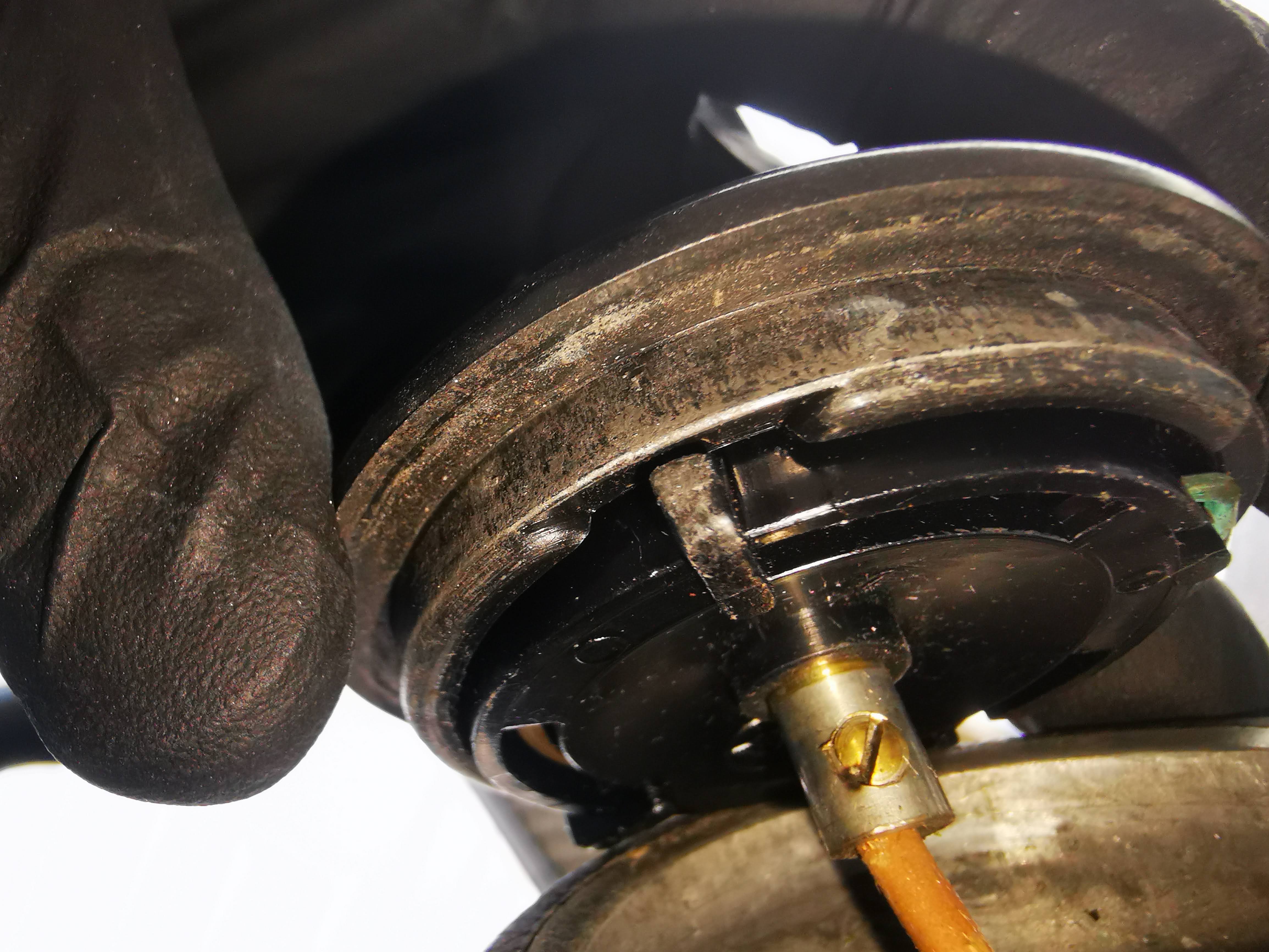

i had the same,
pop the steering wheel horn cover open,
you will see how they wired it,
mine was touching ground when turning the steering,
I attach 2 pictures that might help a bit, but as soon as you will open it, you will understand where the problem is
Re: Horn beeps on hard turns.....
Posted: Fri Jun 07, 2024 9:21 am
by rmel
Put some shrink tubing over the bare brass post. If you don't have a heat
carefully apply heat form a small butane lighter. And yes, I had the
problem too.
