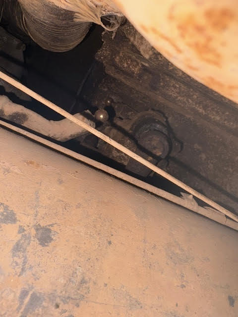

Hey there, can't engage gears. Had a mechanic look under it and said there is a missing 'shifting fork'. Does anybody know anything about this. Thanks

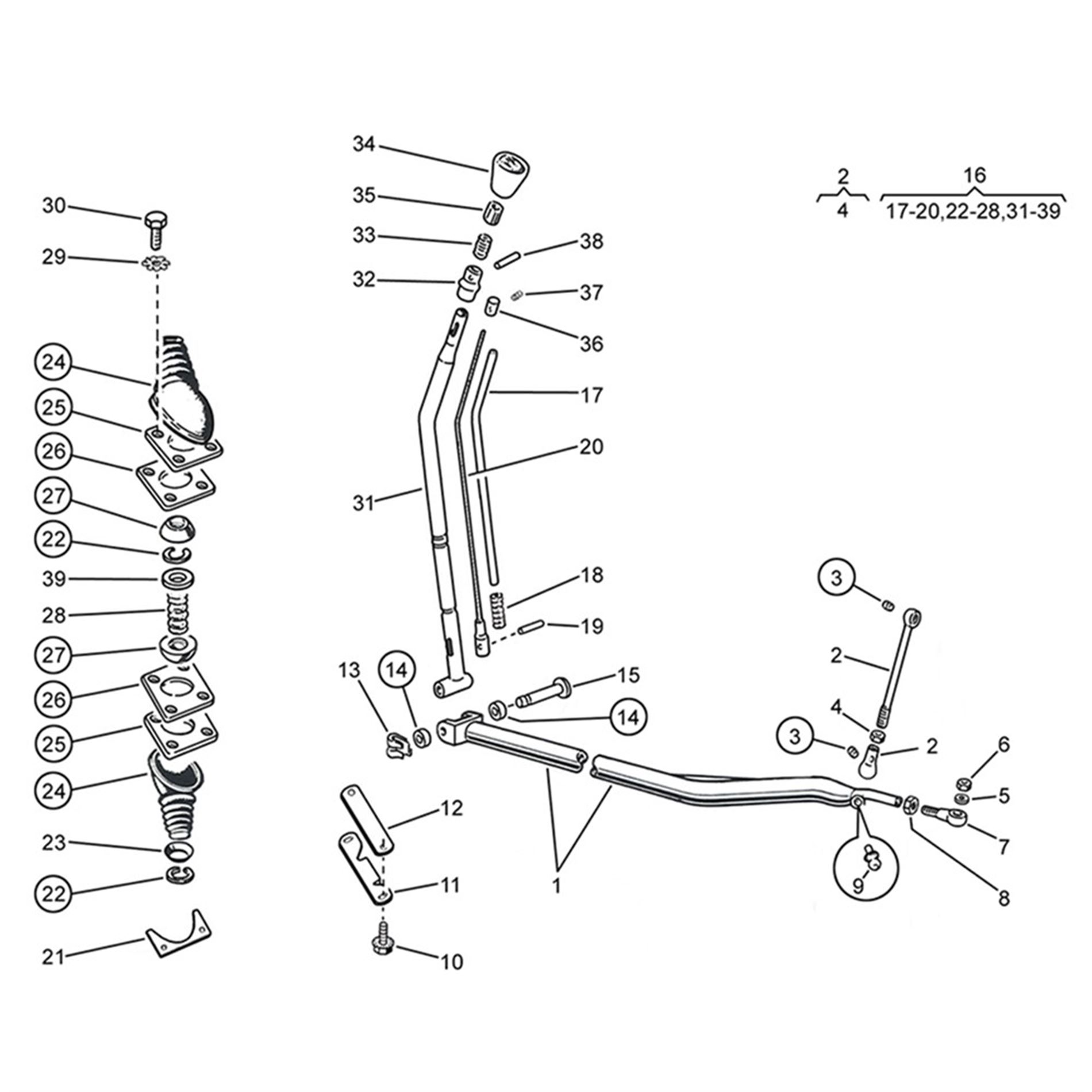

These are the parts you should see on your 710, Austrian army version.

Maybe share some pictures.

Had it for 10 years. It was working before. Trying to get the photo soon. Thanks so much

I'm trying to put the pic in. Computers are a problem for me. Sorry

difficult to judge from your picture,
but i just made a short video showing how my 710M is attached
show this video to your mechanic with the exploded view above, then he wiill be able to tell you if something's not right.
