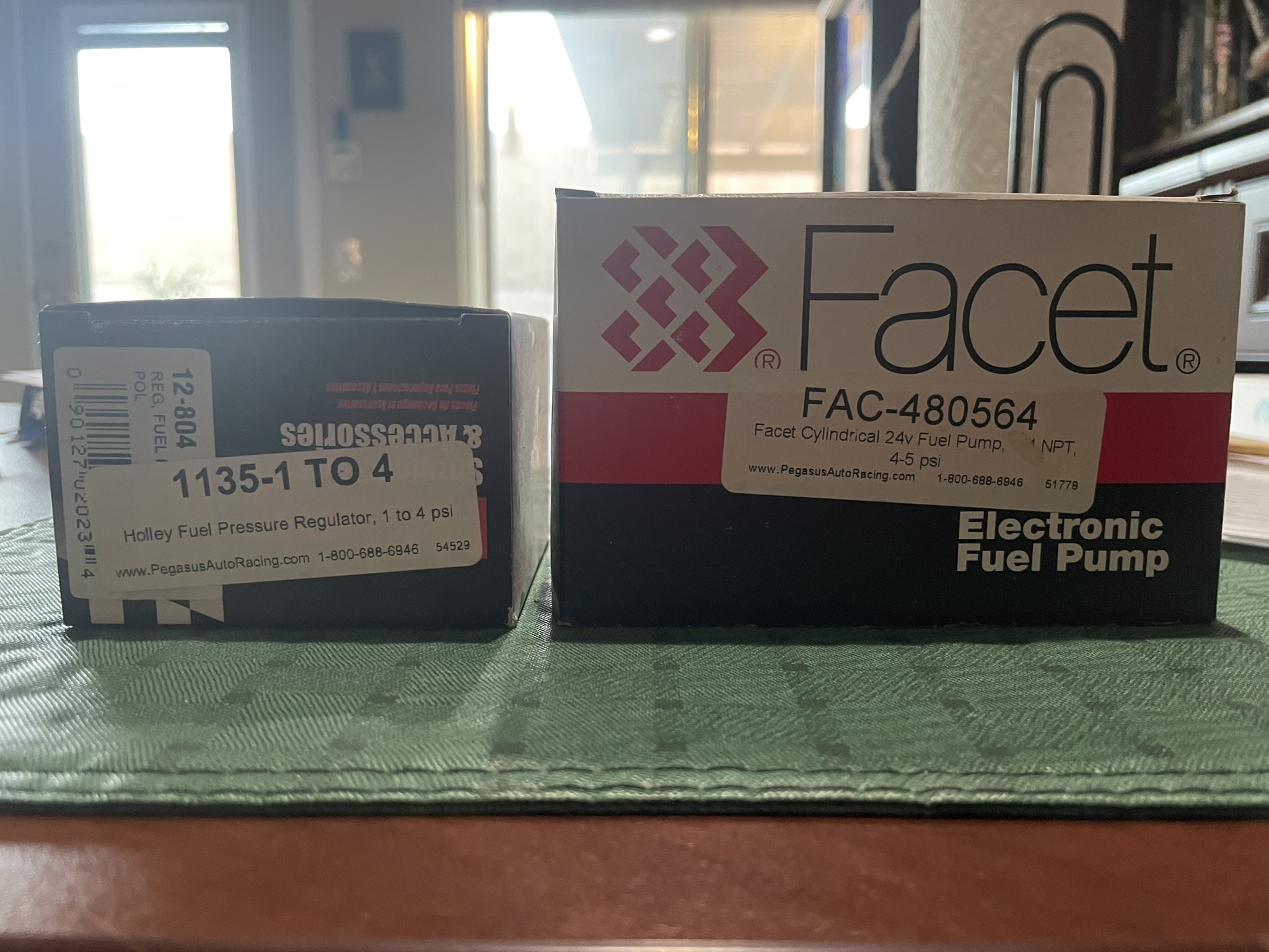

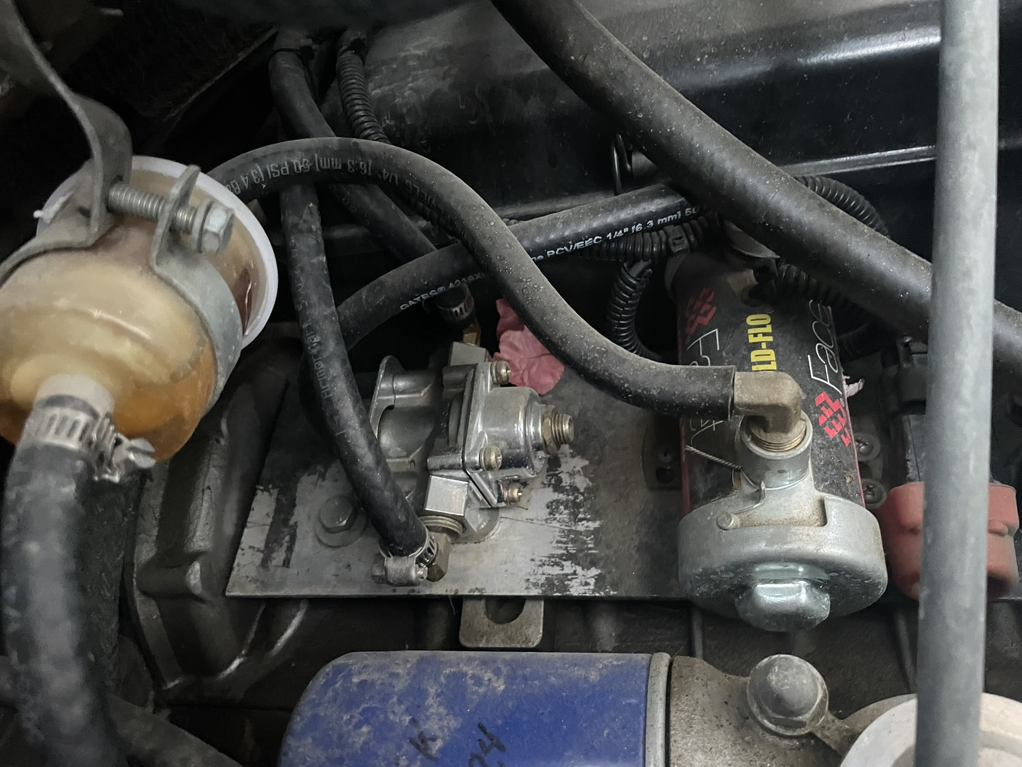

I installed a Facet 24 volt fuel pump in June 0f 2015 along with a Holley fuel pressure regulator. The pressure was set at 3.5 PSI, which may be too high.
I made the electrical tap at the fuel solenoids, which is not recommended by most mechanics. The location of the pump is right where the mechanical pump used to be.
No problems in 11 years. It's nice to be able to turn on the key and hear the pump build up pressure before starting the engine, which reduces cranking time. Having PinzTronix helps, too.
IMG_7544 (1).JPEG (734.07 KiB) Viewed 66 times

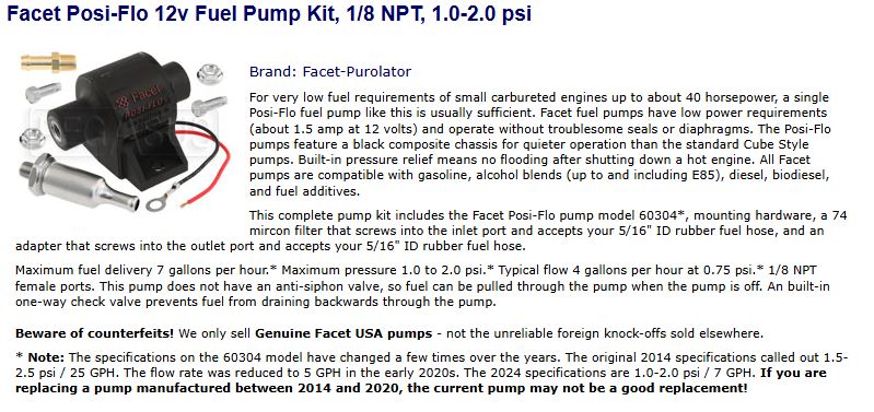

If you have PinzTronix you could add this fuel pump to the voltage converter and replace the mechanical. Is 2 PSI enough? I don't know, perhaps some of you have an opinion.
Note- this pump has a check valve.

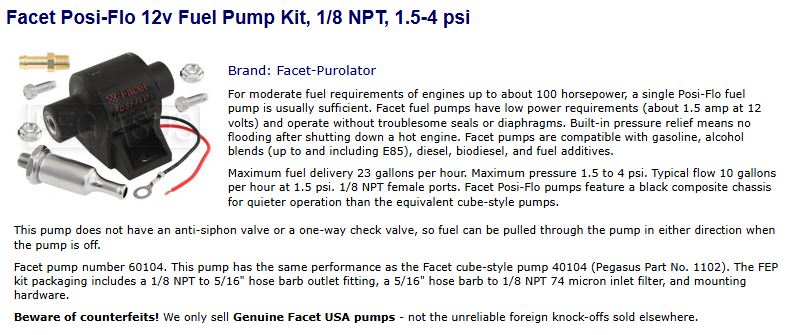

This may be a better choice for a fuel pump, and may work without a pressure regulator. Only the 12 volt version is available.
