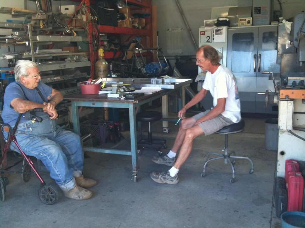

Here are a couple of pictures of the local fabricator’s benches; just some ideas
With the heavy duty wheels they are able to roll them around pretty easily
