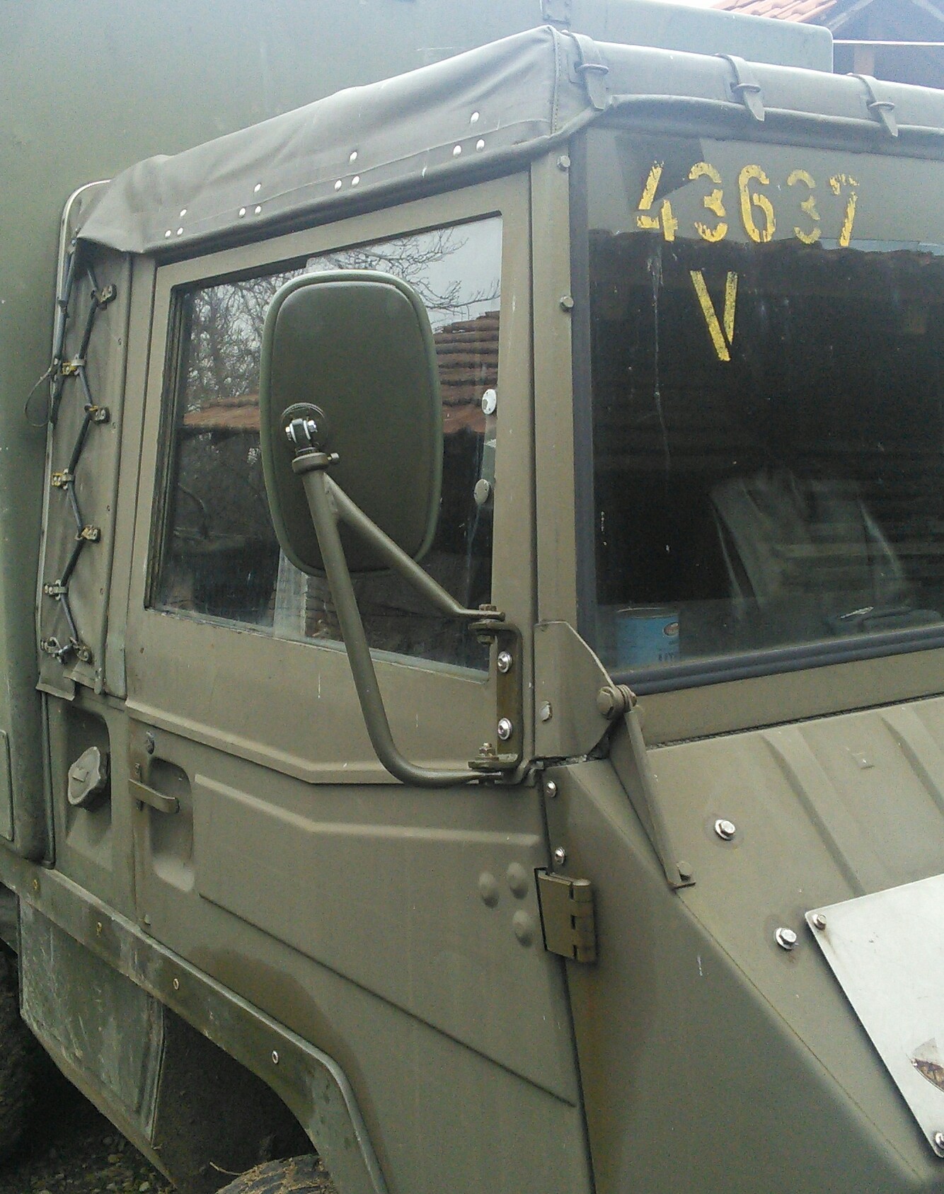

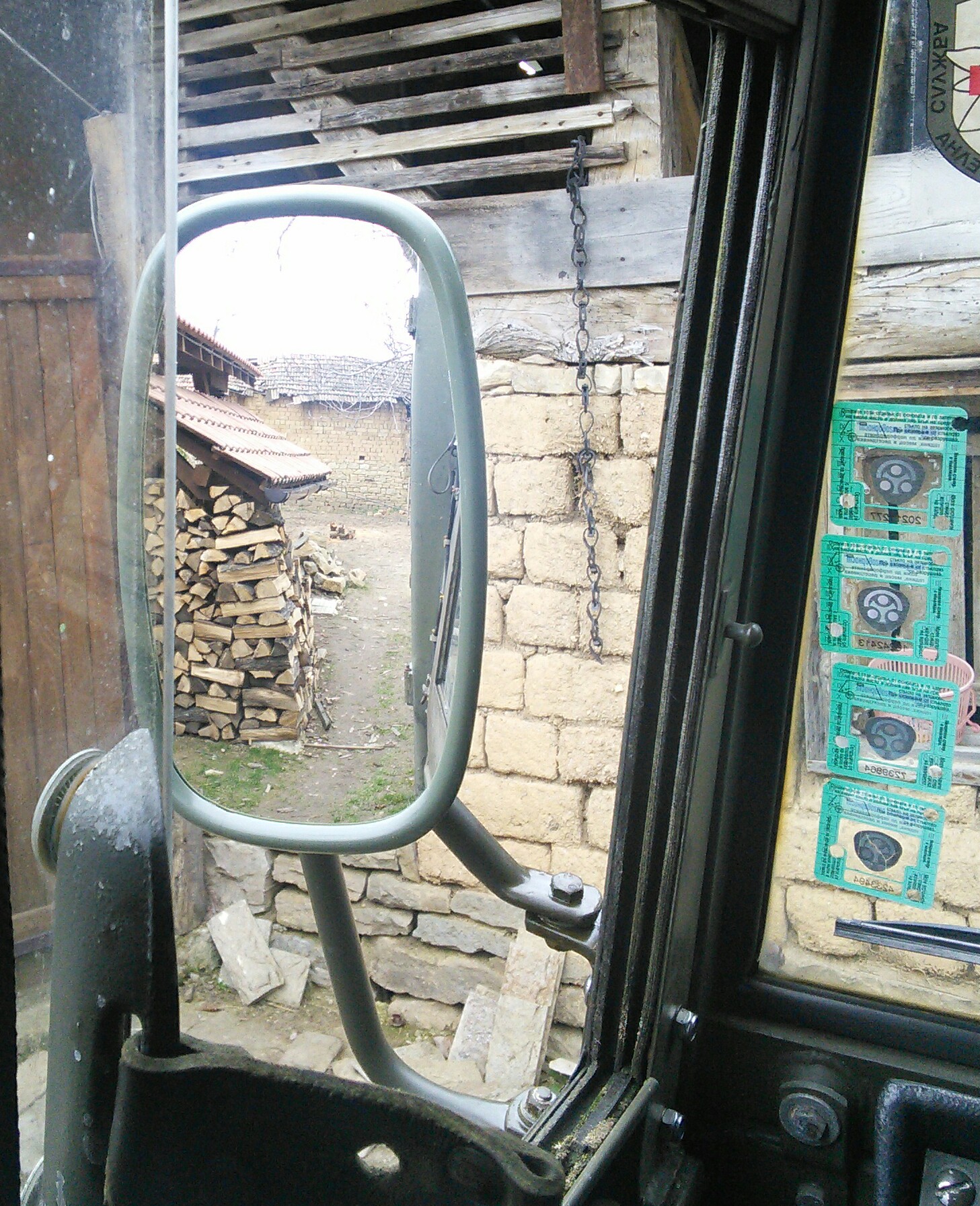

Today I fitted some mirrors - the originals were removed by someone in the yard I found the vehicle in, and are probably now adorning a Gaz truck somewhere...(along with the tools, cable, chains...etc.)
The arms are MB/ Unimog 404 from a dealer in Germany, from whom I also sourced the mirror heads (Faun military truck) Total cost about €60.
A little fabrication required to mount the mirror heads to the arms, but pretty easy.
I needed to get mirrors on to get the vehicle through its test prior to reregistration, and I couldn't justify spending close to €200 for original parts.

- View from driver's position
- IMG_20150322_172133~2.jpg (805.66 KiB) Viewed 13827 times
- IMG_20150322_171957~2.jpg (494.62 KiB) Viewed 13827 times

Those look really nice. They are definitely tougher than the original ones, which were designed (I think) so that they could easily be turned in in order to be able to swing the door open all the way forward.

Why not mount them to the original location? What do you do when you take the top of the doors off?
Re: Replacement side mirrors
They would interfere with the upper door hinge. Bracket is too big for that location. But it could have been mounted to the hinge itself with some countersunk machine screws.audiocontr wrote:Why not mount them to the original location? What do you do when you take the top of the doors off?
To be honest, I bought the brackets with no idea of the scale of them - they're pretty massive! I thought I might manage to mount them in the original position, but that wasn't feasible due to the size.
The door-tops will probably stay in position, because most of the time out here in the wilds of Bulgaria, we're pushing through overgrown trails, and I don't much like getting brush-whipped in the face!
For now they'll do to get the test done, and I'll probably made something else in due course which mounts in the original position...
