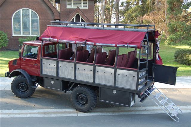

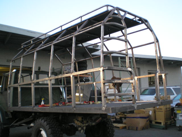

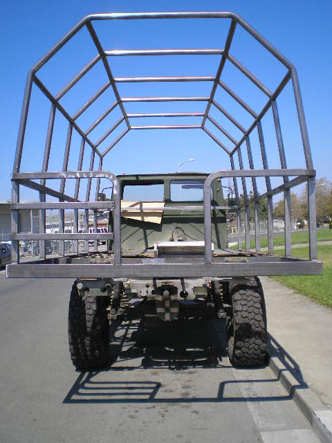

Once you have your design, send the Bend File that is output to a company that does Mandrel Bending to spec. I have found them to be amazingly cost effective versus trying to purchase the materials and bend it up myself. You will also not get Mandrel bends from a home bender.
Attached are pics of one of our 20 passenger tour pods. Designed in Bend Tech, then sent out to be Mandrel Bent. Once it came back it was a matter of gluing it together! Benefits are you can also do Square Mandrel tubing.....
Scott
Another option for those that want perfect bends.
Invest or borrow a copy of the Bend Tech Software: http://www.2020softwaresolutions.com/
It will take you a couple of hours to be pretty efficient at it.
