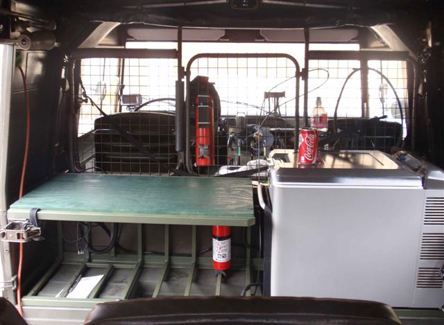

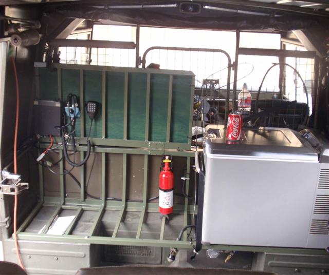

Re: 710K Radio Table Install
Why not just fold it out of the way? :lol: :lol:

Nice mod Ed! Regards, Kevin

Hey edzz,
Really great idea, makes me wish I had a "K"... but where are the cup holders?
