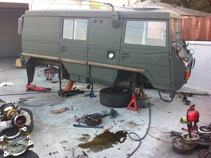

cruzoropeza
Posts: 126
Joined: Thu Nov 25, 2010 12:15 am
Location: Los Angeles, CA
Re: Transmission Input shaft
Post by cruzoropeza »
been there take it a step at a time! your lucky you know where the problem is, one of my transfer gave out in my pinz and i could pin point where the problem was i ended up taking it all apart to find the problem!
at this point a started getting worried if i was going t be able to remember how to put it all back together!

cruzoropeza wrote:been there take it a step at a time! your lucky you know where the problem is, one of my transfer gave out in my pinz and i could pin point where the problem was i ended up taking it all apart to find the problem!
Man that looks like a project from .....! :lol: I don't mind spilting the case (been in a tranny or two) but sure would like to know gaskets, seals ect that i will need and a few i might need. When doing it i would like to tear down and build it back in the same eve. Keeps thing fresh on where they go-went-might fit :roll:
