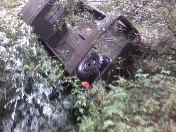

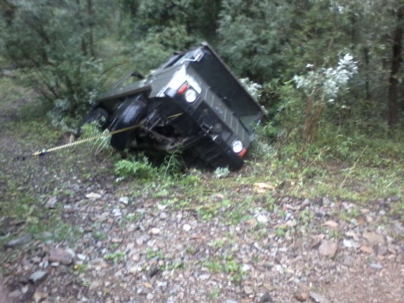

Backing down a mining road on a rainy day, I missed a turn and dropped into a gully. I will try to attach photos (first time at this). Right rear wheel is suspended in air about 5 feet above the bottom of the gully. Left rear tire on soft ground. Right front tire in the air above the roadway. Left front tire just touching the side of the gully. The vehicle is essentially being held up by bushes. If I try to tow it, it will drop to the bottom of the gully. :(
So, I need to lift it out. Question: Can I tie sling straps to the front and rear bumpers? If not, where do I have to attach them. I would rather not get the body all bent up. Really appreciate your suggestions. :D
Pinz Stuck 2.jpg (85.71 KiB) Viewed 5869 times
Pinz Stuck 1.jpg (75.3 KiB) Viewed 5869 times

I might try that, if my original thought fails. But as you can kind of tell from the second photo, the right rear tire has slid off the road down to the very edge of a vertical drop-off. If I tug on the hitch, I will be pulling the vehicle into the side of the ditch. And I don't believe I have enough room to pull the vehicle sideways. If I pull it straight out from the front, the back end will drop straight down (12 feet). I have located a giant front loader that can reach over the top of the Pinz and lift it - which will guarantee that the Pinz doesn't roll over sideways. But I'm not sure what is the best attach point for a sling.

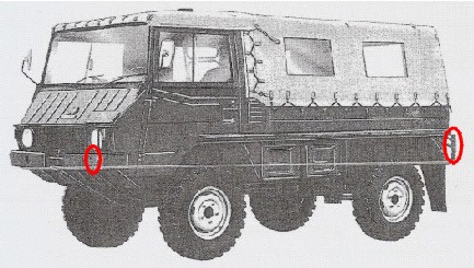

Dreadnought: Thanks for the suggestion. I had pretty much convinced myself that the back bar and front bumper would hold - we're talking about 500 lbs load at each point. UPDATE: JUST DISCOVERED THAT WAS KG, IT'S MORE LIKE 1100 LBS PER LIFT POINT. BACK TO BEING NERVOUS!!
Just to be sure, I have marked the attached photo to show where I plan to tie the sling straps on the left side of the vehicle. I would do the same thing on the right side.
Any concurrences would be mightily appreciated! :lol:
Pinz Lift Points.jpg (41.49 KiB) Viewed 5833 times

Well, if you're plucking it, why not go entirely under the whole truck, center tube and all. Secure one near the front axle and one near the rear and lift. I'm sure it's not a recommended lift point, but considering the alternative might include dropping into a gulch, it might be the best you could do.
If you're going to use the front bumper, I'd go for the center, so at least you're near the center support.

If done carefully and slowly there will be minimal strain on the structure of the Pinz. The body tub and the tube are very stiff structures and very strong and when joined together...well I cant think of anything I,ve inspected closely that is anywhere near as strong size for size. We are not talking some generic pick-up truck here. So unless you have had previous massive damage to the tub, those points at the back will be fine to lift the pinz as high as you like.

I remember seeing a video posted on a site called formula one (now no longer up) and it showed pinzgauers being airlifted in by helicoptor the sling was placed just as the picture in the post before mine...on the 4 outer corners of the truck....good luck with your extraction!!!!!

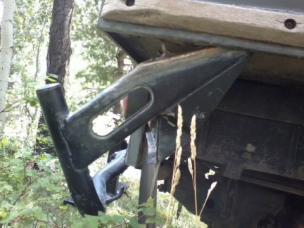

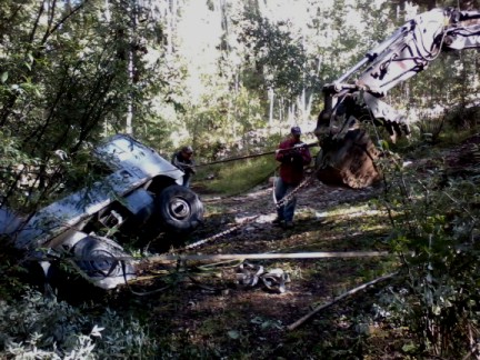

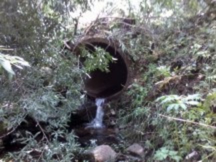

Well, I got the Pinz out of the ditch and hardly a scratch. I opted for a track hoe (see photo). The operator wanted to just pull it straight out, but I was paranoid about the rear end. The only thing that was holding the Pinz out of the gully was that the tranny box hung up on a 4' culvert flange (see photo). I feared that if it slipped off, the Pinz would be nose-up vertical or upside down. So I insisted on also hooking to the rear end. I had slung a strap from the left rear bumper up around the tub, and he was afraid that the side would get caved in. So we also slung to the right rear bumper to share the load. He kept the bucket real low, and the result was that it broke the right rear bumper loose (see photo - notice that it is pulled down). He then tied onto the right rear axle. The Pinz was literally pulled sideways and then forward out of the gully. As the tires dug into the ground, I thought one would pop off the rim, but it didn't happen. Not a scratch on the downhill side of the pinz. Only damage was a broken bumper and a flattened brake line. The Pinz started with difficulty and then smoked for awhile - lots of oil has apparently drained into the cylinders. But it's running great now.
Cinched Up S.jpg (60 KiB) Viewed 5613 times
Culvert Flange.jpg (36.37 KiB) Viewed 5613 times
Bumper Damage S.jpg (39.65 KiB) Viewed 5613 times
