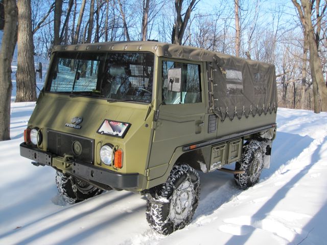

by krick3tt
Used 1 1/2'' metal channel, chamfer the leading and trailing ends.
Stand off from the frame with 1/8'' washers.
http://s400.photobucket.com/albums/pp88 ... MG3360.jpg

I also did like krick3tt and used steel channel but used rubber grommets to stand off the body. The rails provide a good spot for stick-on reflectors.

I too did what Paul and Moris did on my previous 710. It gets the attention of the cars that park next to you for sure. They can tell that they're the ones that need to pay attention before they go swinging their doors open!

If you go to a steel supply shop, you could walk in with the old wooden rail or simply note the length and width on what you need. They should have different profiles available. Pauls photos very clearly show the sort of shape you're looking for. You can paint it to match or contrast with your body (your truck's, not your's).
I'll tell you what, once I replaced my damaged wooden ones with steel replacements, any trees that saw me coming ALWAYS got out of the way quick because those steel rub rails probably looked pretty menacing!

I too used metal-3"x3/16" angle in an 8 ft. length. I chose the 8' length because it was easier for me to work with (vs.10' length). I cut the leading edge at a 45 degree angle and rounded the rear edge with a hand grinder. As I am not a purist, I 86'ed the nut-serts and had the rails welded on after filling in the holes for the nut-serts. Total cost including the welding (since I don't weld): $140

I removed the wood ones, measured them and went to a metal shop and had them cut a stock 20 foot piece in two.
Took it home and did the chamfers with a hack saw (had no grinder then) very slow process...use a grinder. Matched the holes
from the wood and used the same stock screws with 1/8 washers to stand it off. I use the stand off to mount my tables for camping.
Cost about $40 for steel and $2 for washers. The cut was free. Gave them a few coats of paint and installed them. Started in the middle
and let the metal pivot for end line up...yeah they are heavy but not impossible. 'C' clamps help.
