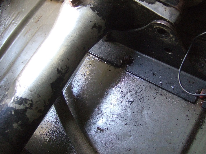

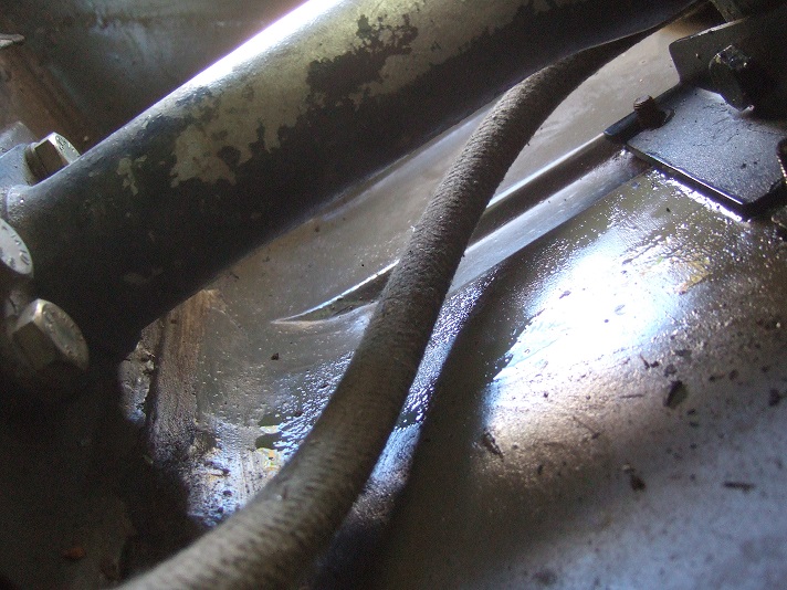

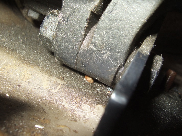

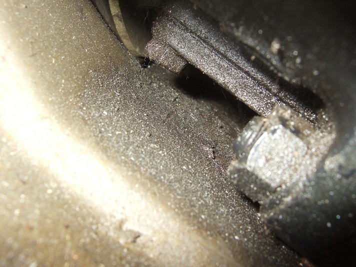

Hi gents,
In the first place; thanks for replying so quickly. I really did buy my Pinz, after I found out about this forum, I thought I would be 'save' with problems.
I was starting to worry about road-safety, imagine the steering-column locking up while you're driving on the highway.
I also felt very relieved, when I read it might be just the seal and filling up is just a good option, until it gets fixed.
Any idea how much trouble it is to renew the seal ? I read in the repair manual that it is very involved: pulleys to remove the steering-drop-arm and the steering-wheel even...
Attached 4 pictures, 2 are clear: showing that it leaks from just under the support bracket. The other 2 are taken from the left of the steering-column. The partially shown nut (top left) is the front-bumper-bolt. It does show that it is 'greasy'. Don't ask me what that orange blob is. Looks like a grease-mop.
Really appreciate any comments about repairing the seal, while in the meantime I'll just fill her up...
Thanks and regards,
Jules

Quite often a slow leak can be dealt with by topping up with a mixture of oil and some sort of seal expander from your local auto supply. Check the capacity, calculate the goop needed , add it and top up with oil. It may work and it certainly won't do any harm.

Re: Tough to turn
You might also consider using a heavier weight gear oil as a temporary measure until fixed properly. I use 90w, but straight 140w is available in some auto parts stores here in the U.S. More viscous, but should still provide the lubricating properties needed for the steering gear.
