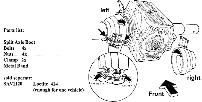

As directed by SAV I used Loctite 414 to glue the split together. 414 is actually superglue formulated to work fast and strong with rubber. It will also glue your fingers together or to the boot very fast, and yes, I learned the hard way. :oops:
Instructions from SAV (with some minor editing from me):
- Remove old boot and clean area.
- Do not grease boot or axle parts.
- Put the split boot on the axle.
- Coat the split area with Loctite #414 and press together. Hold until dry (approx 30-60 seconds depending on how much you put on).
- Slide the split boot towards the differential housing as far as it goes.
- Rotate the boot until the split points to the front on the right side (passenger) and to the rear on the left side (driver).
- Install the new clamps. The tightening bolts should be on the opposite side from the split.
SAV Split Boot Inst.jpeg (68.35 KiB) Viewed 8295 times
Ed's/Paul's instructions sound great also. If you combine everything and use your own common sense it should come out fine. :D
