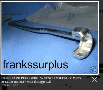

That bottom image is the kind of thing I've been thinking about. I just need some strong wire stock, a ground off crow's foot, and some time on the welder. Or does that thing already exist off-the-shelf for 19mm? I've seen images of them (below), but none for sale quite yet.

https://www.ebay.com/itm/M38-M38A1-M151 ... SwMSxfzUk5
You may have to cut the handle down to make it fit the pinz space (or lack thereof). 19mm = 3/4"
