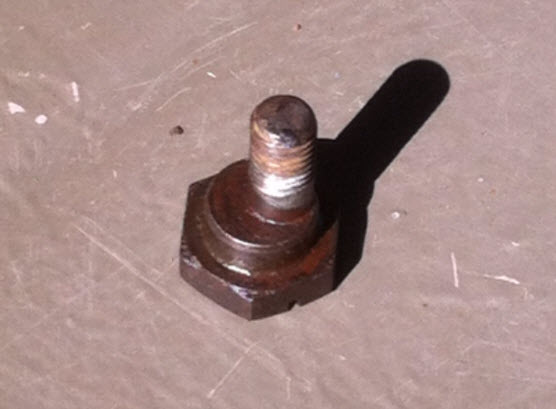

Here is that 712.1.19.027.1 "tension screw" up close. I had my stuff apart syncing carbs anyway (thanks Dennis for the technique).
Does not look terribly hard to fab-up and it does not look to be under much stress. Once you set it, you tighten the nut on the other side to keep it from rotating.
$30 plus shipping does make it quite special though.
