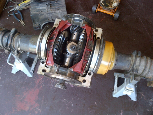

Re: Big bang, now metal "rattling" sound...yikes!
stiffler4444 wrote:Sounds like a Saturday project to me. I the meantime, I'll start looking at parts/$$$, just in case it is the gears. And yes, I hope there is not too much collateral damage....pinzinator wrote:Parts are available. Just hope the case hasn't been damaged. With some good jack stands and a floor jack you can have the differential out in a couple hours or so.
If you were closer, I would love to help you out with this....if it is the problem. Here's opening it ain't!
