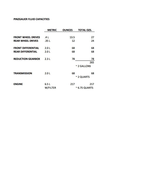

Hi All, I have just purchased a 1979 710M that needs some work doing on it, mechanically great but the body is showing its age. Can anyone help with the volumes of oil required for engine, gearboxes and hubs? Also, is there anything to watch out for whilst servicing the engine/axles/boxes. Thanks for your help!

Here you go:
Pinz Fluid Capacities.jpg (22.69 KiB) Viewed 2117 times
