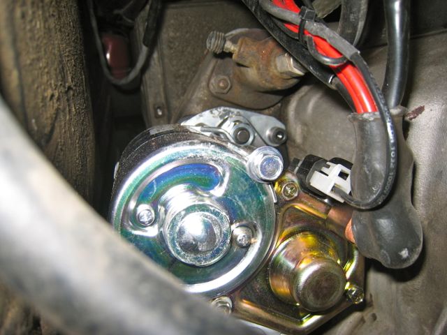

The side unit is the solenoid and is included with Scott's starter. The only changes I had to make on the wiring was to slice open the sheathing on the main harness slightly, about 1 inch, so that the main leads (red) would reach the starter terminal. Also you'll need to splice the black wire that goes to the solenoid to the short lead that comes with the new starter. Both are vary easy mods requiring no special tools.

Yes, remove the air filter housing and the oil filter (for better visibility). Also it's helpful but not absolutely necessary to remove the access panel behind the right front wheel. It's held in place by (4) 6mm bolts. I'm assuming that you're referring to the top bolt towards the engine. A crowsfoot wrench should get you in there and you will only get a small turn each time but it does work. If you do switch to the gear reduction starter, it is much easier to access the bolts.
I took the opportunity to switch to new bolts and changed that tough access one to an allen socket bolt.
