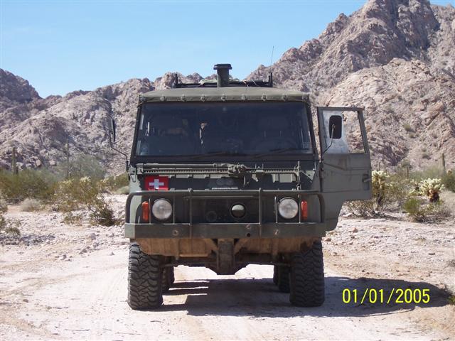

here is mine showing tires leaning in. This is from lower tire pressure (what is your pressure now since you said you were playing on the beach)
some have made up spacers to make the alignment pin longer which makes the tires set up straight. Stan or Mark have done these and would know more about what it takes.
The cups are more susceptible to failing on the top where water and mud get trapped and rust out.
- 100_3307 (Small).JPG (66.33 KiB) Viewed 8475 times
