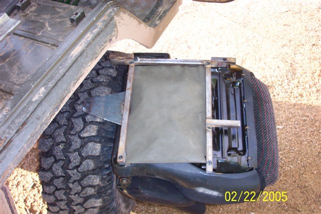

We have had great success either matching stock height or lower. It just takes some looking at the junkyards. Find one where the seat pan is depressed in the center and the mounting holes are up at least an inch. I think we have use GEO metro seats, several honda seats (not the prelude, too big), the crx seats work really well with a custom seat bracket. So much depends on how they are mounted to the frame (stock or custom) and not the seat as much. You can just see the seat pan pushing the material down (up in the photo). The seat pan sits 3/4" off the floor and the crx seats are only 2 1/2" thick. This set up is as low as I have done. At 6 1 I don't come close to the head rest but still can't see overhead traffic lights.

4x4, if I help you see traffic lights, will you make me a set of those crx plates? Mine are way too tall (but still use the stock adjustment mechanisms)
Would it really need the metal plate? Seems like the outer frame would be enough.
