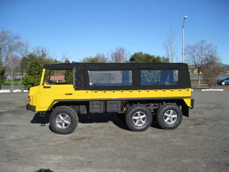

Hi Guys,
We found these relatively inexpensive wheels from the Dodge Sprinter Vans. The kicker was finding a Lug Bolt that would work with the new wheels as they have a conical seat versus the military ball seat and you cannot use the stock bolts. Anyways, replacement bolts came out of Italy and make it a bolt up conversion. Pictured is with 255/85R16 Maxxus Big Horns.
If anyone is looking for some extra combat wheels drop us a line and we have 15-20 spares!
Scott
Vallejo, California
www.expedition-imports.com

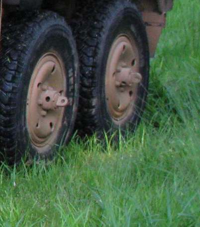

Do you have a pic of the mil wheels you have there? Wondering about fitting to a G... are they number 34 or 35 on this list? (6.5" or 7")

vince I think these are the mil wheels he has.

Hi Vince,
Mopar is correct, I have the Delta combat wheels which are incredibly heavy and pretty hack in terms of balance. Definitely not the G Hutchinsons.
However, if you are going to be taking gunfire and want to continue to drive, give me a call :)

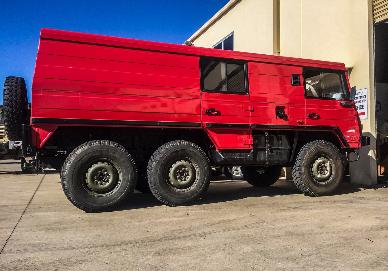

Hello Together,
I'm Steve from Sydney, I just bought myself a 718K P80 Pinzgauer and I'm new to the Pinzgauer.
Have had 2 Defenders but sold me tourer no replaced by the Pinz.
Just saw this thread and was wondering whether there is a list of wheels which fit from other
brands, I saw the Dodge ones but they will be hard to get here in Australia.
Any help would be greatly appreciated.
Steve
LightRoom_catalouge_New-2.lrcat_-_Adobe_Photoshop_Lightroom_-_Library_2017-05-30_10-25-09.jpeg
LightRoom_catalouge_New-2.lrcat_-_Adobe_Photoshop_Lightroom_-_Library_2017-05-30_10-25-09.jpeg (477.58 KiB) Viewed 17828 times
Pinzgauer 718K P80
Defender 110
www.youtube.com/alloffroadau
Re: 718 Wheel Options
The dodge is just a Merceded Sprinter re-branded here in the USA. You need the 5 lug type - so prior to 2007. The sprinters wheels are deep offset / high ET - possibly more than the stock Pinzgauer wheels - and they are only 6 inches wide - so it you want a wider wheel then look at aftermarket alloys for Sprinters - they also seem to have less ET / offset.
Looks like a nice truck! Welcome to the forum!
