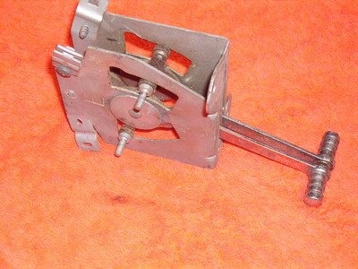

Does anybody know of an "off the shelf", preferably, three lever control unit, similar (or smaller) to the two lever one in the 710/712 Pinzgauer?
(couldn't find a photo online so did a quick pic)
I'm working on a mod for the 718 and have searched the web in vain for such a unit, but I daresay after I finally decide to make it, someone will say they know of one that is readily available, hence the post to try and avoid that situation :D ........Thanks!

This is lose as I can think of.
http://www.mcmaster.com/#throttle-cable/=l83wvq

Don't know how long of a throw you need, or the total cable length, but ebay has some lawn mower cable control units that might be
modified to your use:
http://www.ebay.com/itm/Murray-420005ma ... 35c3db2c16
or:
http://www.ebay.com/itm/NEW-OREGON-THRO ... 27ceb5cc37
Ford Mustang 3 cable heater control unit?
http://www.ebay.com/itm/1965-1966-ford- ... 2c&vxp=mtr
Seems that 1960's era cars (Mustang, Buick etc...) used 3 cable control units for heating/vents. Many more of these are on US ebay, some in pretty good looking condition and may only need a handle/knob modification to meet the 718 military style.

Only a two lever but....
http://www.ebay.com/itm/200885173335?redirect=mobile
Three lever....
http://www.ebay.com/itm/170908873817?redirect=mobile

might also look into the Isuzu NPR ac/heater controllers.
sounds like a trip to the salvage yards.

First of all, thanks everyone for all the posts.
A lot of the items look like they may "fit the bill" but I'II have to do some research as the area in which the "lever control" is to fit is fairly small and many of the items sizes are not listed.
I do like the Fiat 124 Spider unit and I'd grab it on the off chance that it might fit if it wasn't for the high postage cost to Australia (twice the cost of the unit) but I'II look into all the options first.
Dave, the reason for the "request" is that I have in mind to modify the centre dash panel of the 718 so I can fit a 10" tablet into the dash, for navigation etc.
As I'm sure Dave is aware, but for the benefit of everyone else, the heater unit in a 718 is behind the centre dash panel and the heater controls (which are in the top hole) are moulded into the heater housing so cannot be repositioned.
I'm planning on cutting off the control unit which will then give me more space, then "cut and shutting" the vac form to incorporate a dedicated tablet "depression".
I'II not lose anything on the original dash that I care about, only the ash tray (and I'm a non-smoker) and the cigarette lighter which I plan to move elsewhere and change for a proper 12/24 volt output.

I am assuming you plan to put the controls to the left of the dash in the 'lower' area of the center panel?
Have you thought about rotary cable controls?.. just a thought

There are three "levers" on the original setup Dave (Temp, Demist and Cabin control) so I'd like to mimic the original setup.
I had thought of using rotary controls but given that I want to avoid making the panel radically different, or any larger, limits the surface "real estate" and position somewhat, so levers attached by short flexible cables appear to be the best option.
