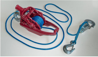

So I have used my fair share of winches (Warn electric, Werner PTO, hydraulic etc) and I always read and debate about things like which one is best, mounting (front, back, both, detachable), how to wire it, best batteries, how to mount in bumper, what rating etc etc.
Like most, I don't need/use a winch each time I go wheeling as I don't always get stuck, it is one of those items that you never need until you need it and without it your screwed!
This got me thinking...what would appeal the most to me would be something that is transferable to various vehicles regardless of their voltage (12 or 24) and vehicle weight, lightweight, easy to store, could be used to help others that are stuck, and could be used as a hoist.
So here is what I am in the process of ordering:
It does not change the appearance of a vehicle (that can be good or bad as winches do look cool), needs no new/modified mount, can be used front, back, side, hoist, and everything else on my wish list plus it is field serviceable.
http://www.wyeth-scott.com/models.asp
Model 3-35-A-SLT a 3 ton (6,000lbs) hoist and has a 12,000lbs double line drag rating with Amsteel 5/16" synth line.
It is only 24lbs and while it only has 35ft of line an extra 100 ft of 5/16 Amsteel is fairly inexpensive, light weight and really simple to store (will probably end up ordering 2 50ft lengths with finished thimble ends).
Way I see it is this will work on a Haflinger, Pinz and pretty much any other vehicle other than a big Mog
The only real cons I can think of are that it is slow, only would go about 15ft and is a manual but considering how often I will use it I don't care and could prob use the workout.
While these are not cheap they seem very solid and built by 4 people in Newark, Ohio - I like that and it is worth extra $ to me!
Anyhow, interested to hear any thoughts/comments before I commit

- 3-4-2013 10-28-57 AM.jpg (20.91 KiB) Viewed 5154 times
- 3-4-2013 10-24-54 AM.jpg (27.74 KiB) Viewed 5154 times

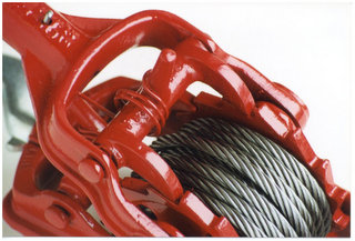

Having used hand winches for all manner of things, from cave exploration to tree felling, those ratchet ones suck (by that I mean ratchet ones in general, not specifically the ones from that company).
Two big problems- lack of range, and lack of controllability in both directions.
I think the hand powered winch has its uses in a truck, but the Tirfor style cable winch is a far better tool. You can winch in or out under load and if you can carry it, you can have a wire rope a hundred yards long. It also feed through as fast as you can haul it when in open mode, so you don't have to inch your way up a cable to get it to where the work starts.
I have a case with a full winch kit in it, sitting in the back.

Yeah I have researched the Tirfor but I think they only work with steel cable and I was trying to avoid it as it is harder to store, heavier, does not float etcbonefish635 wrote:Having used hand winches for all manner of things, from cave exploration to tree felling, those ratchet ones suck (by that I mean ratchet ones in general, not specifically the ones from that company).
I like the way the Tirfor work!

I use a Tirfor style (grip hoist) and have for years. with an abundance of offroad vehicles I did not want to buy a dozen winches. The grip hoist can be located at a convenient spot to set the pinz back on its wheels when needed without the use of multiple snatch blocks. It is slower than an electrical winch when pulling from the front of the vehicle and assuming you still have electrical power during your recovery. Each style is going to have its advantages and disadvantages. The grip hoist tend to be heavy but I would not trade mine for any electrical winch that is mounted to a given point on a vehicle.

I have a Tirfor and swear by it for function and diversity of use. The product you’re looking at troubles me due to the design, it looks too short, and a lot of energy in cranking on it will be lost with the winch twisting as you apply force especially with the synthetic rope.
Now with enough pulley's you can use a standard cum-along to upright a Pinz but the movement to effort exerted will be high. The Tirfor is a great balance between Effort and Speed.
