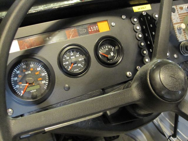

1. See here: viewtopic.php?f=18&t=5326&hilit=Model+265
Scroll 1/2 way down to see front and rear LED side marker lights - 12v run in series - very clean and neat IMO
2. VDO is the way to go
Sample install pic (not my truck)

X2 on the VDO speedometer.
Here's the unit complete with the needed sender: http://www.pinzgauer.com/showdetails.ph ... no=SAV1406

Put them in both of mine. Only complaint is that after three years the speedo stopped reading in the 710 but the odometer works and in the 712 the odometer only displays about 10% of the time. Have checked and rechecked electrical connections and wire routing to ensure no damage and all appears normal. We have had a couple completely fail but that was after five or more years in service.
They are really a great alternative to the original. At least when they work they are FAR more accurate then the original ever was since you can adjust them for the tire size you are running.
