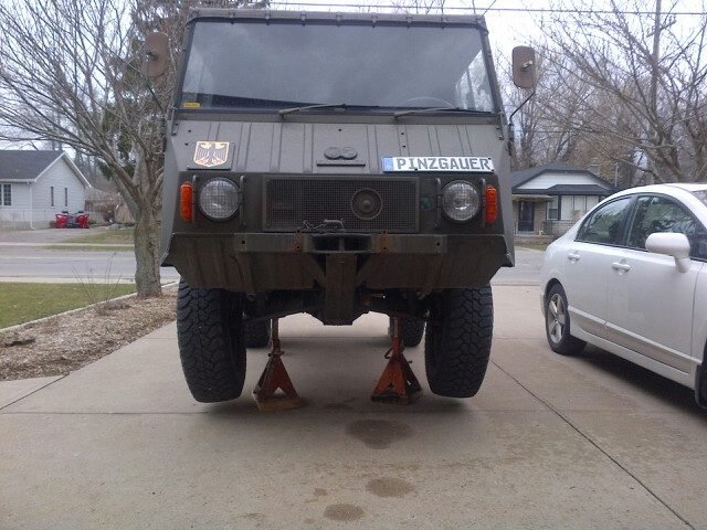

At some point I want to tackle my diff seals and I want to ensure the truck is properly supported, as it may sit like that for a while. I discovered that many guys use a cribbing of either 12" pieces of 2x4 or 4x4, screwed together, and the stands on top. What do you guys think?

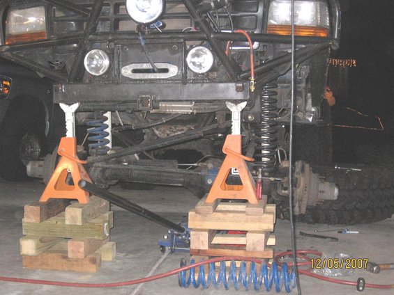

This is a rough example. I would make a solid top platform...and it would be screwed together with deck screws.

4x4's with solid 2x tops but I would lag everything together for better shear strength.
I would also make the bottom solid so it is stable in all directions

4x4 cribbing is the standard support used for fire and rescue operations and is approved by pretty much all agencies. I have used it to prop up overturned 18-wheelers before and one time, a train car! I have never seen a need to bind or screw the wood together. The bad thing I see in that pic is the use of the jack stands on top of the cribbing, which is unstable. I'd just use the cribbing all the way up. We always had some 2x4's and wedges to fill in gaps. Just cut some 4x4's in half, at a 45 degree angle, and you have two perfect wedges out of one piece.

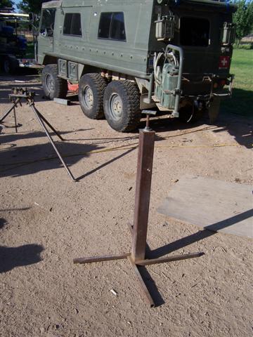

I just use the large jack stands. Much less chance of something going wrong. I made four body tub supports for when the running gear has to come out or when I want to stabilize the truck when working on it. a 3" square tube with a pipe welded to the top plate that the threaded rod drops down into. The rod had a bearing plate that can be screwed onto it. I chose to screw it on rather then weld it in the event I would like a different attachment. These stands allow adjustment of body height and add support.

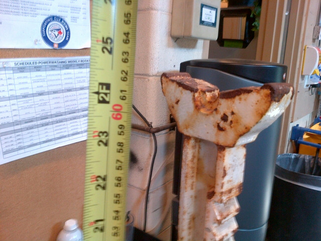

Ok, so the stands I am using are 8 ton capacity and stand 24" when fully extended. As you can see, I have mine out only 4 "teeth", and when fully extended they have 10 "teeth" visible. I figure your 6 ton variant might work out.

ok so yours are 24" with 10 teeth showing (and I figure an 1" per tooth)
So with 4 teeth showing they were 18" + the wood

Ya, that sounds about right. They're a bit of overkill so the ones you are looking at should serve the purpose.
