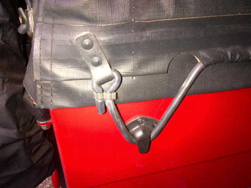

OK got my clamps and tile nippers and dulled them a little. Any one have a picture of of a crimped clamp? do I just crimp the 2 ears or do I crimp the middle?

Re: Crimping Rubber rope for the top.
I just use channel locks and squeeze.
I crimp the 2 ears and then squeeze the center area with channel locks if needed.

OK got it figured out Muttandjeeps sent me a picture. Thanks

Some pictures of the crimps for future reference as I did not have and of these clamps on my rig to go by.
Just for archive: how did you end up crimping?
Buy the tool, Channel Locks or did you use the tile nippers?
Crimps look good!

I used a pair of pincer pliers from Lowes crimped the ends first and then the middle. I dulled the plier ends up a little on the sander first so I wouldn't cut through the clamps.
