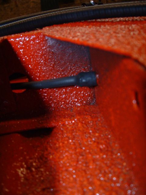

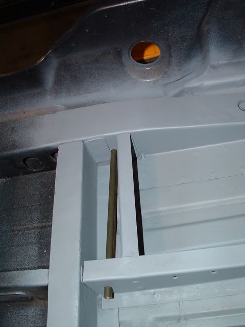

There is supposed to be a length of steel tubing which is welded at each end to the platform brace and the firewall. See the photo below. The choke cable runs through this tube. The heat shield plate is spot welded over this area.
If the tube is not there then it has likely rotted away. You could either replace the tube with coated steel fuel line (as I did) or just "fish" the cable through using some drill rod or wood dowel. The second photo shows how I sealed the tube & cable with heat shrink to prevent water entry. If you replace the tube fill it with silicone grease (Dow 111 for example) to make cable entry easier and prevent rust.
