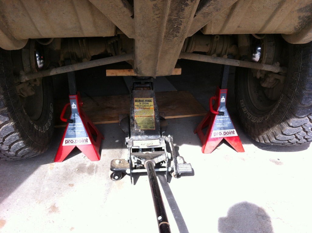

Front of the truck chalked and the rear lifted onto jack stands.

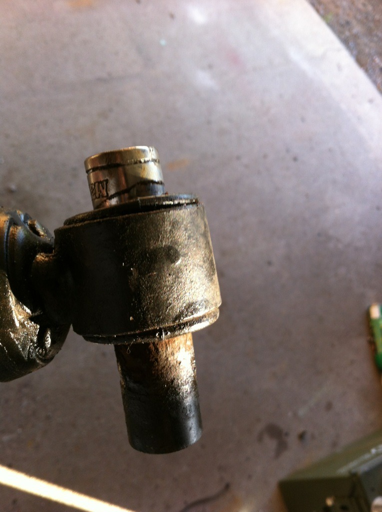

I went with the breaker bar and 24MM impact socket and the bolt came free without issue. I then used an e-impact gun to speed up the removal.

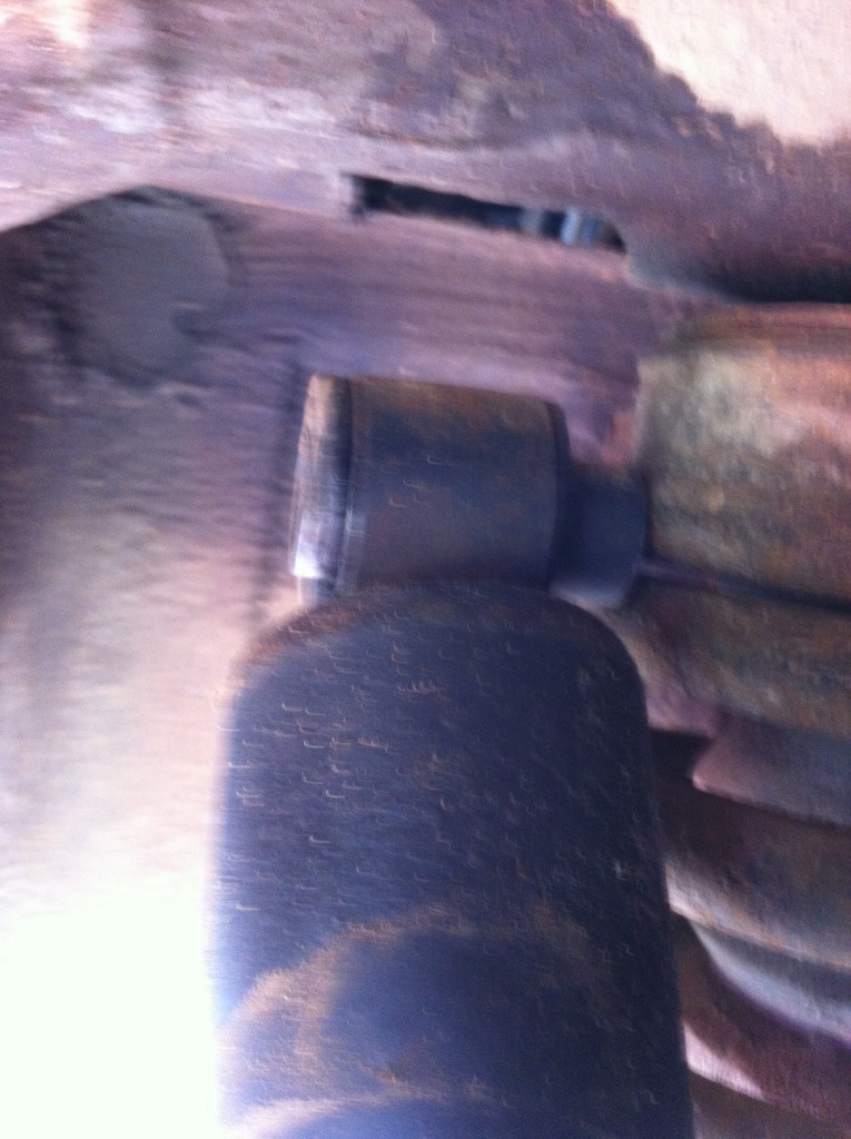

I then did the same for the top bolt, using the breaker bar and 24MM box wrench.
The threads on all the bolts were in great shape. I used brake cleaner and a brush to clean them up.
