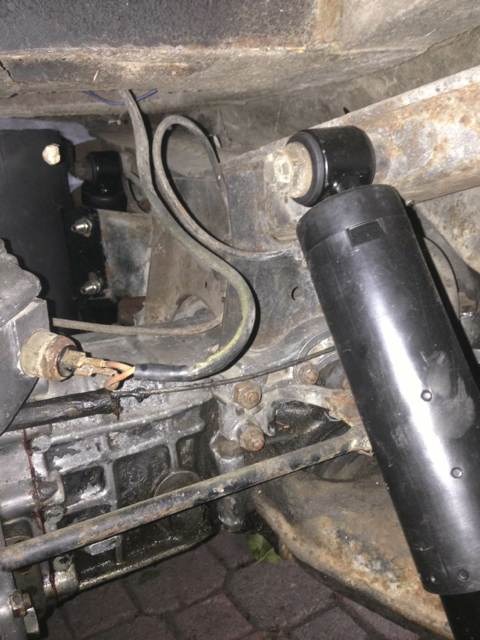

Only had about 20 mins to take a look tonight
Looks like it is not just a simple cable fix but can't see much (ie can't see fork etc)
Not looking good
Open to things to check 1st before I attempt to rip it all apart!

Garrycol
Posts: 423
Location: Canberra Australia
Re: Clutch issues today!
Post by Garrycol »
I suppose that if it is not a cable or linkage issue it will be drop the engine to have a look in the clutch itself - however in my previous experience with cable clutches (not Haffies though) it will be a cable or cable mount issue.

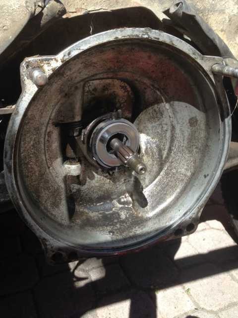

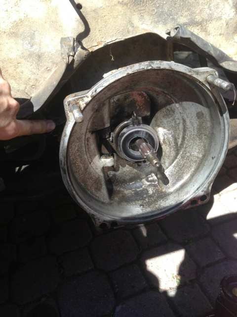

Engine out in a couple hours (love these vehicles!)
But I don't see any major issues but I also have little clue what to look for as I am just a backyard mechanic
Spring, fork and mount look ok to me - not a ton of pressure required to push back and forth (I can do it with 1 finger but that is probably because clutch springs are not in the equation any more?
Now that engine is out it may just be a stretched cable :mrgreen:
Time to redo engine perhaps and get engine compartment reprinted (when what I really want to do is drive it in the limited Canadian summer!)
Will get a better picture of spring and other parts
Few parts on order - will keep the thread up to date with progress once I get some time to work on it

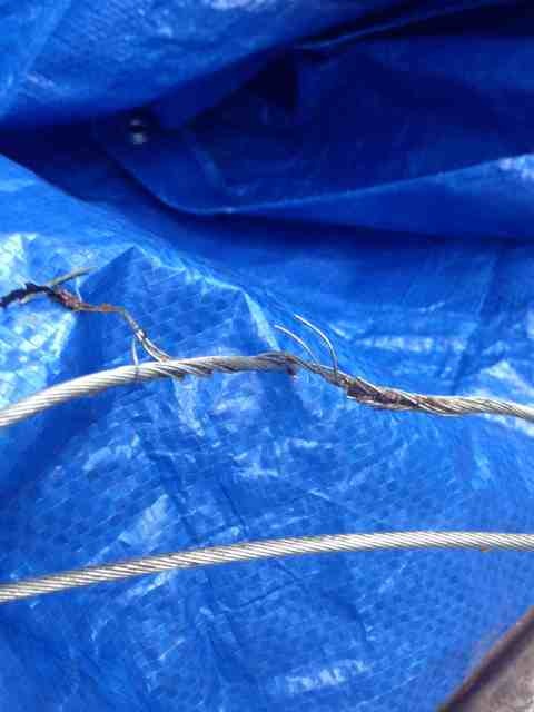

Well good news is below
Just waiting for new cable to arrive
Happened where it comes out of front tube and goes into long rear tube
Hope it arrives in time for next weekends trail ride!

Heinkeljb
Posts: 396
Post by Heinkeljb »
Lets hope that is the culprit - check the alignment between the two tubes as it fraying there suggests it has been rubbing on one or other of the edges of the tubes.
Put the end of the new cable in the tube by a couple of inches, then start smearing the cable with grease, that way the end which comes out won't drag . push the grease out of the tube whilst you put the cable in. Also means the end is easier to deal with when connecting up. Can be covered in grease afterwards.
