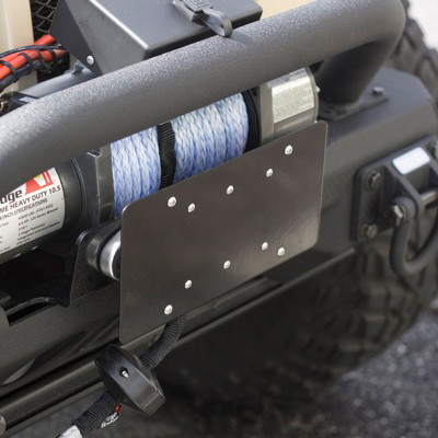

Once I get it I hope to add an Andre (Andre - I will PM you - may as well ship it to Jim vs to Canada) winch mount and use one of these to mount the lic plate:
Some great ideas there, thanks. I plan on putting a winch bumper on, but until then, I'll just get a nice looking from and mount it to the OE bumper.

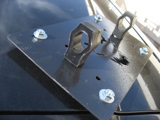

Re: Front license plate
Posted: Sat Jul 27, 2013 10:13 pm
by berger
I made a sheet metal plate for the drivers side too, using the Euro bolt holes and some rubber grommets as spacers. I then bolted my license plate to it. The spacers allowed for the small nuts and bolts to clear the nose, yet tighten down on the plate.
