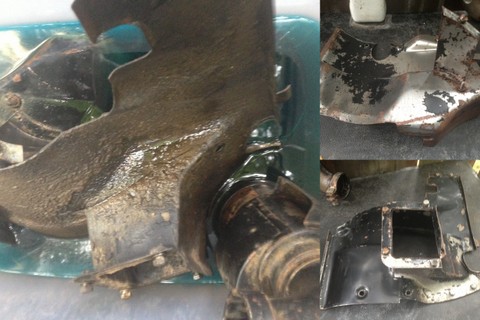

Here is what I worked on today:
Hard to see the 1/4"+ thick mud and oil all over the tin!
ImageUploadedByTapatalk HD1377991507.755311.jpg (53.35 KiB) Viewed 12921 times
ImageUploadedByTapatalk HD1377991558.203418.jpg (48.64 KiB) Viewed 12921 times
Haflinger - Fan.jpg (39.18 KiB) Viewed 12827 times

Looks good so far and I look forward to seeing the progress. My recommendation is to protect your tin, take it in to a powder coat shop, have them blast it, then go back and check for any hairline cracks that may have formed over the past 40+ years and repair if necessary. then have it powder all coated before you put the new decals on. I have been very happy with mine.

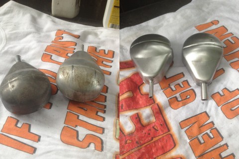

Did a few small jobs today
Haflinger - Gov.jpg (46.89 KiB) Viewed 12827 times

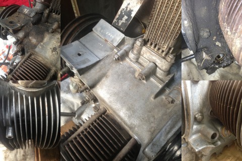

Wow the engine is nasty!
Still not done - I feel like once I fire it up oil is going to spray from every seal - not sure how so much oil got all over it!!
As for powder coating: thought about the Eastwood home kit but I may just spray tin with a 2 part black semi-gloss.
To many pictures so I will edit and make them into a few different collages
Haflinger Cleaning-001.jpg (54.17 KiB) Viewed 12827 times
At least you will be able to find the leaks now!
What are you using to clean it?
I'm doing the same thing, but mine is so junked up I have a mind to attack it with brake cleaner/carb cleaner just to get some of the crud off..
I have been scrubbing with a brass "toothbrush" and all I do is spend dime trying to clean the crap out of the brush.
Simple Green ain't cutting it.
For the tin I soaked it in parts cleaner
For engine and other parts I can't submerge I started with a plastic scraper, then moved to a stiff nylon brush and shop vac (all the big thick stuff), then a brass brush and various tooth brushes (filed down to different sizes) and a pile of rags.
To clean, I sealed everything that I did not want cleaner to get on or in and I used Eastwoods PRE cleaner - similar to brake cleaner but it leaves no residue.

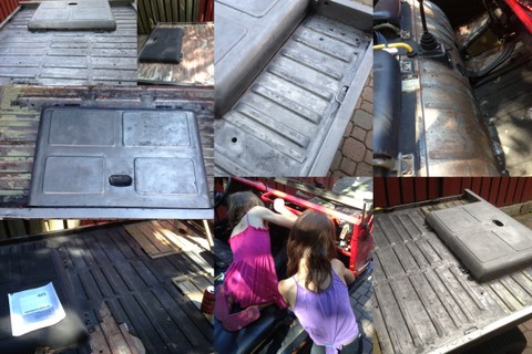

Bedliner removal - just adding a collage of resto projects
Haflinger - Bedliner remover.jpg (57.84 KiB) Viewed 12829 times
