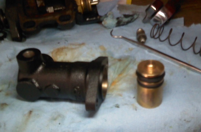

Looking for ideas on how to get a piston out of a slave cyl.. It's stuck in there pretty good. Using the hyd. hose hooked to the master isn't budging it and I assume air won't be much better. (plus I dont have air anymore)
Sorry about the crappy cell phone pic.

Thanks for the tips. I soaked in parts cleaner, then PB for a while (that's what I had on hand). The coolest advice came from someone who suggested using a grease gun. I found a metric grease nipple at Pepboys that thread into it and applied grease and it came right out. I feel stupid for not thinking of that one. Anyway, I used steel-wool to smooth out the brass where it bound up (darker colored area) and some light pitting in the cyl. then used some Eastwood black paint to finish off the body. The rubber was still good. It now works like new! I can get fully locked up for Utah in the spring.
Don't forget to exercise those lockers once a month! I bet this thing hadn't been engaged since 1990.
Sorry again for the crappy cell phone pic (it wont focus anymore).
Before:
