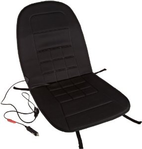

I recently picked up a couple of these to try out:
http://www.amazon.com/AmazonBasics-12-V ... at+cushion
They are 12V so you would need a 24-12 convertor. They work pretty well - not a huge amount of heat but definitely helps.

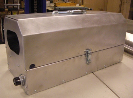

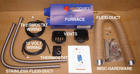

Re: 24VDC Heater OPtions
Posted: Wed Jan 22, 2014 12:34 pm
I have been looking at these (have no experience with them)
1-22-2014 1-28-44 PM.jpg (37.35 KiB) Viewed 10150 times
2 models (note they are 12v and propane so you would have to carry a tank - I would just have a few of the small bottles and you need a 12v converter)
6500BTU 12.5 x 7 x 4" $780.00
http://store.adventuretrailers.com/prod ... S2000.html
9500BTU 16.5 x 8.5 x 5" $920.00
http://store.adventuretrailers.com/prod ... S2800.html
They made up a portable one (kit is really expensive) but you could easily build one out of a tool box
Would be handy to move it from Pinz to tent to storage in the summer
http://store.adventuretrailers.com/prod ... Y-Kit.html
1-22-2014 1-31-32 PM.jpg (24.19 KiB) Viewed 10150 times
EDIT: just found a source that says they come in 24v too
